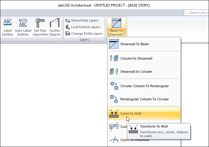

Location of the Curve to Wall Command

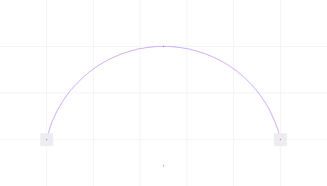

  • Draw an arc or circle.
  • Click the curve to wall command.

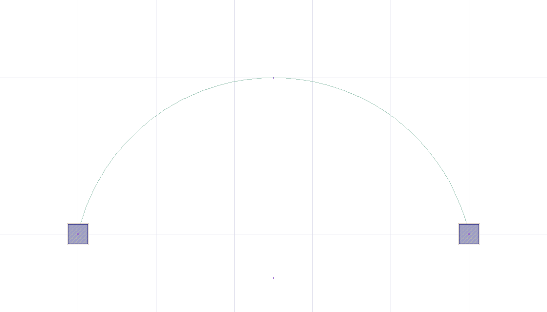

  • Select the arc or circle you have drawn.

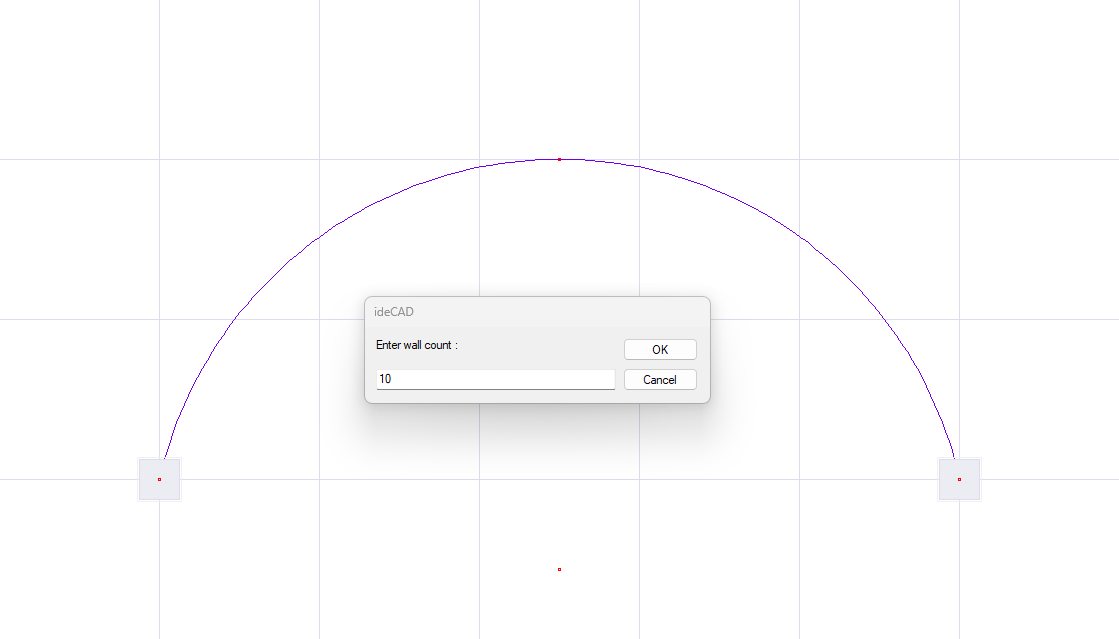

  • In the dialog that opens, enter the count of wall that will make up your arc. The program does not transform the arc or circle into one piece wall. Places the count of wall pieces you will give here on the circle or arc. As the count of walls increases, the wall to be formed gets closer to the circle or circle. For example; If you are transforming a circle to a pitch and you give the number of walls 6, you will get a hexagonal screen, if you give the number of walls 20, you will get a twenty-sided screen The higher the number, the higher the curvature precision.

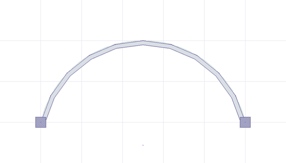

  • When you click the OK button, the arc or circle you selected will turn into a wall.
Arc creation
Selecting the arc to be transformed to wall

Formation of walls
