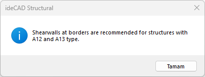

  • If a curtain will not be used in the structure, in the Analysis Settings / TBDY 2018 Earthquake Code Wizard, A11 for High Ductility Level Systems and A31 for Systems with Limited Ductility Level can be selected.
If edge shearwalls are not present in shearwall-only systems (A12, A13), a warning related to clause 4.2.3.4(b) is displayed on the analysis window.
