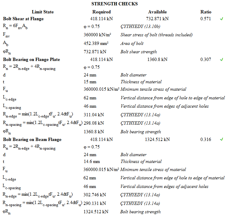

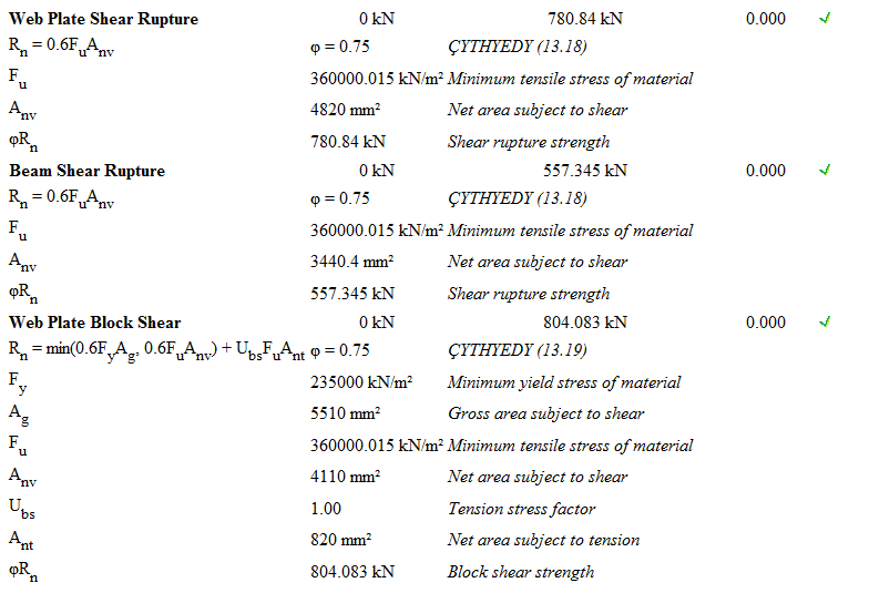

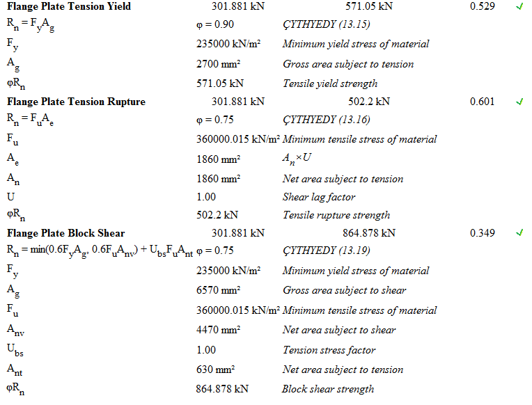

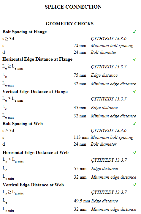

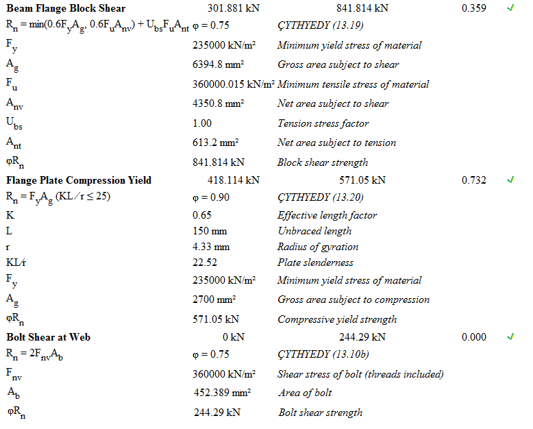

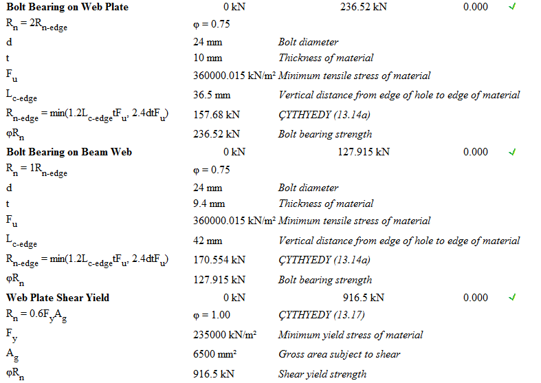

Splice Connection Report 1
Splice connection design is made automatically according to the Design, Calculation and Construction Principles of Steel Structures (ÇYTHYEDY) , AISC 360-16, and a connection report is created.
