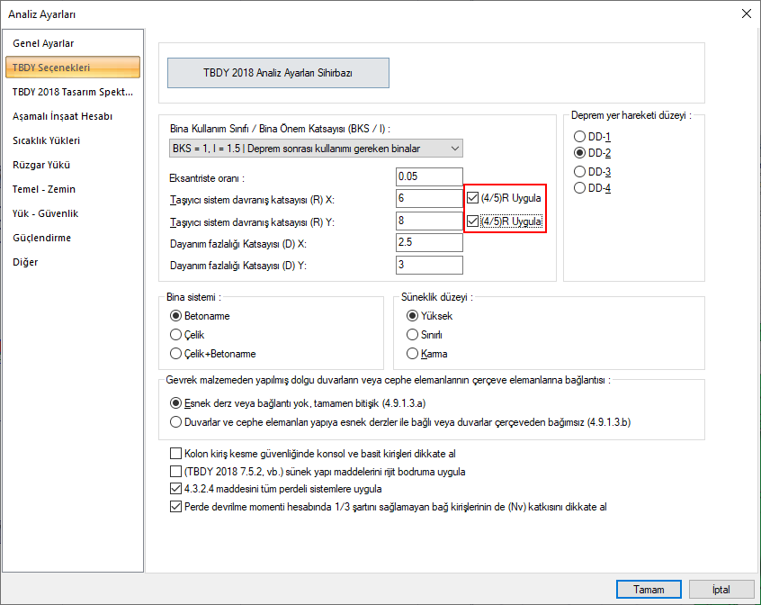

Possible solutions:
  • Providing the above mentioned (a) by adding a sufficient amount of curtain / curtain group or by reducing the overturning moment value of a single curtain by changing the vertical carrier system.
  • (a) If it cannot be provided, check the "(4/5) R apply" option in Analysis Settings / TBDY Options Tab and repeat the analysis in the requested direction.
