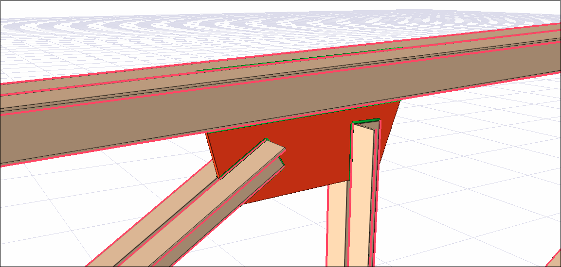

With the Truss Connection command, upper, lower head and trusses strut and crosses are combined. When purlins are defined, their connections is automatically defined. The automatically defined connections can be deleted and a new one can be made.

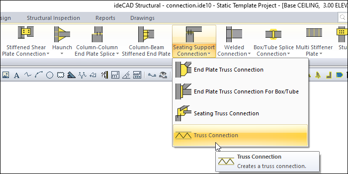

Location of the Truss Connection Command

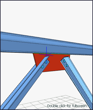

  • Click on the Truss Connection icon from the Connection menu.
  • From the 3D perspective view, select the scissor top and / or bottom header and headers respectively.
  • Press the right mouse button and select braces and / or posts.
  • Double-click the connection to change settings.
  • The connection dialog will open.

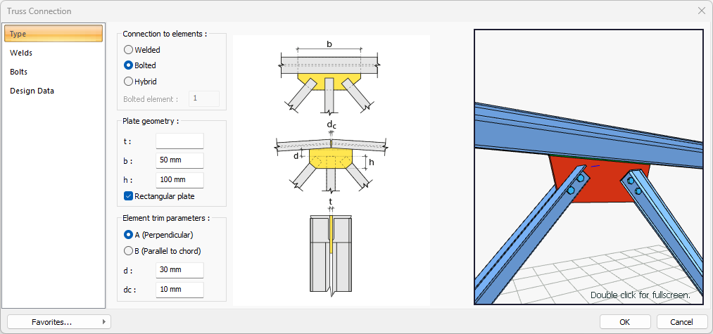

Type Tab
Connection to elements
Welded, bolted or hybrid connection type is selected for combination.
Bolted element
Become active when hybrid option is selected. The element to be bolted is determined.

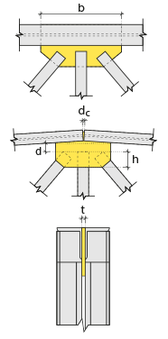

Plate geometry
Plate dimensions are determined by entering values. The values to be entered are shown in the schematic drawing.
Element trim parameters
Element trim type options are given. Also element trim parameters are determined by entering values. The values to be entered are shown in the schematic drawing. dc settings is just for truss top connection. Adjusts the distance between top elements.

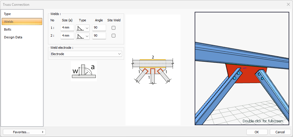

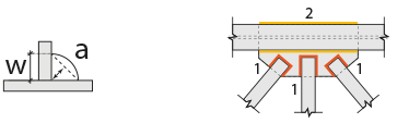

Welds Tab
Welds
Weld electrode

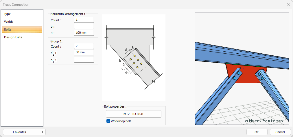

Bolts Tab
Horizontal arrangement
Group 1
Bolt properties

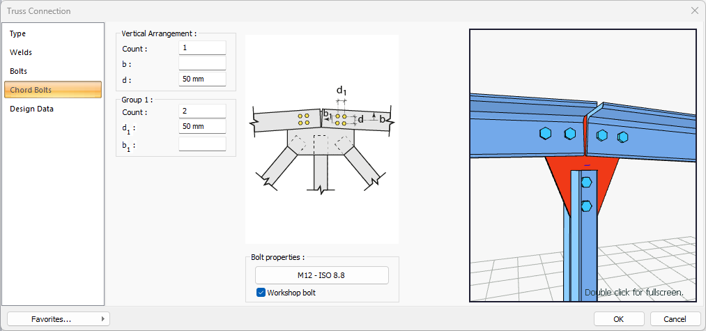

Chord Bolts Tab
It becomes active when the entered truss top connection settings.
Vertical arrangement
The vertical arrangement distance value of the bolts is entered. The values ​​to be entered are shown in the schematic drawing.
Group 1
Distance values ​​of bolts to truss top bolts are entered. The values ​​to be entered are shown in the schematic drawing.

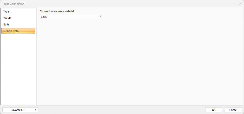

Design Data Tab
