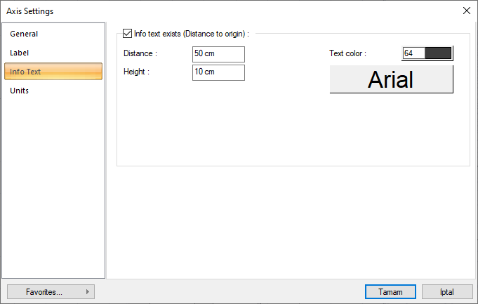

With the Info Text Exists feature, the distances of the axes to the origin appear on the plan view and are printed on the drawing printouts.
Location of the Info Text Exists Feature
You can access the axis settings dialog from the Info Text tab.
The Info text exists line must be checked in the Drawing Details tab of the Layer Settings dialog .

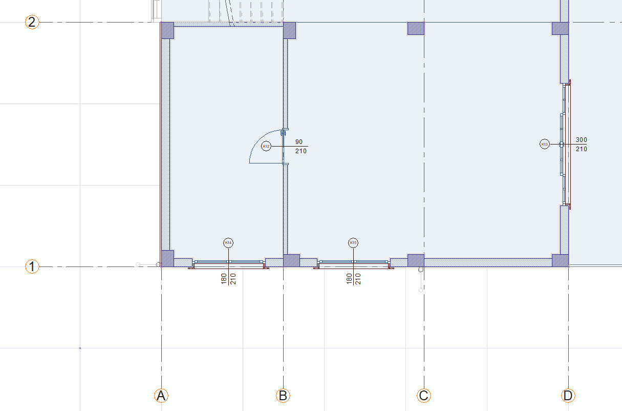

When info text exists is unchecked

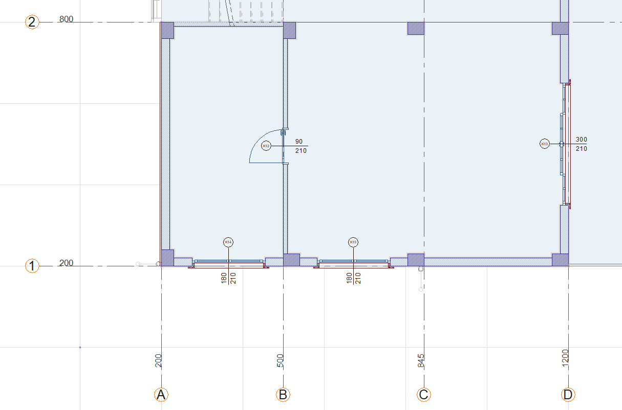

When info text exists is checked
