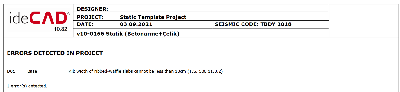

Rib width of ribbed-waffle slabs cannot be less than 10cm (T.S. 500 11.3.2)
According to TS500 11.3.2 for ribbed and waffle slabs, the width of the rib should be at least 10 cm. A warning is given when the rib width on toothed floors is less than 10 cm.
Possible solutions:
  • Entering rib width greater than 10 cm for ribbed or waffle slab.
  • Changing the slab type.
