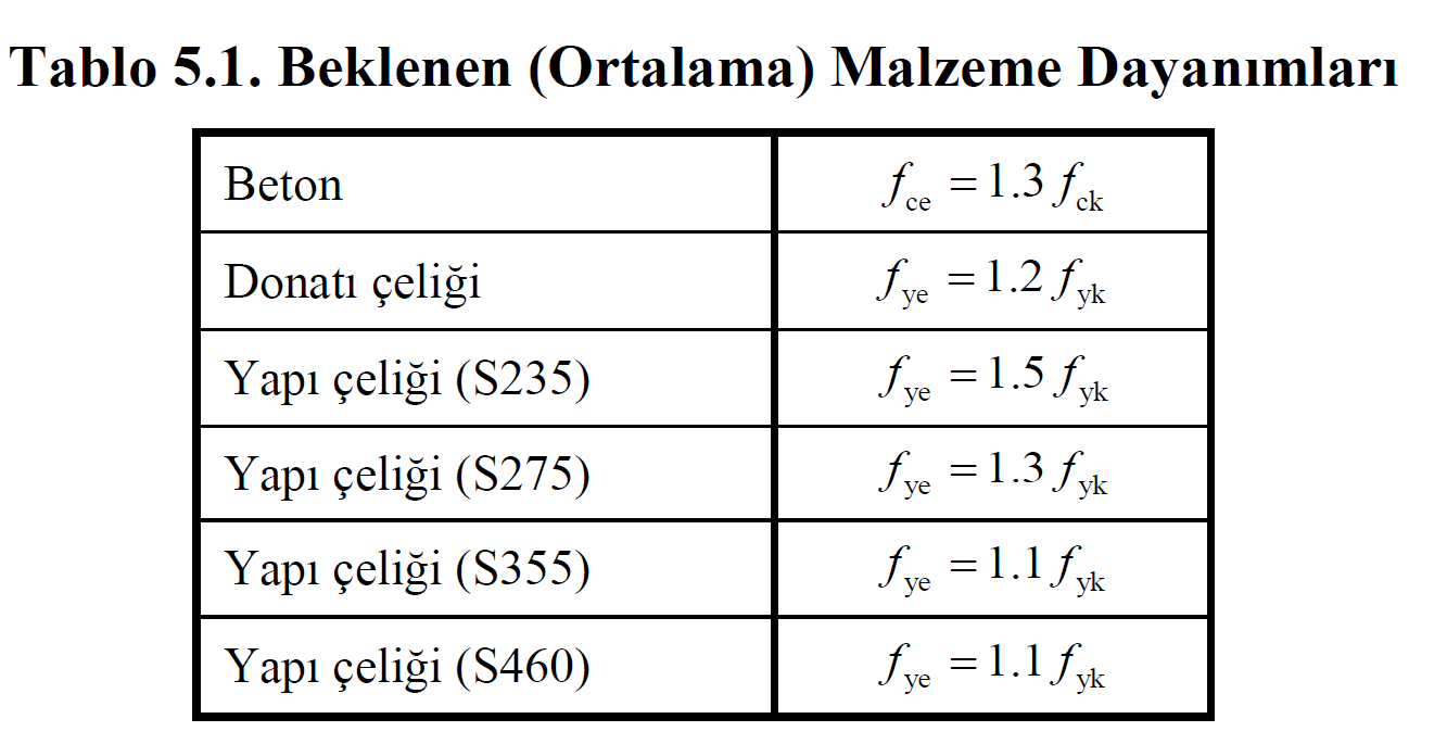

5.4.1.5 - The material strengths given in (a) and (b) below shall be taken as basis in modeling based on evaluation and design according to shape change :
(a) The current strengths of concrete and reinforcement steel defined in Section 15 shall be taken as basis in the assessment of existing buildings according to deformation .
(b) In the evaluation and design of new buildings according to deformation, the expected (average) strengths of concrete and reinforcement steel and structural steel defined in Table 5.1 shall be taken as basis. F in Table ce and f ck concrete and the mean compressive strength characteristic, f ate and f yk shows the mean and the typical yield strength of steel.
