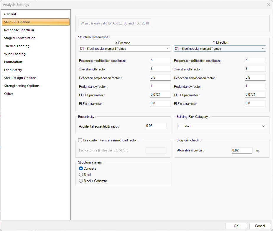

Analysis settings that vary depending on the SNI 1726:2019 are explained in detail below:
SNI 1726:2019 Options Tab
Structural system type for SNI 1726:2109
The type of structural system for the X and Y directions is selected according to the building's design.
Response modification coefficient for SNI 1726:2109
It is the response modification coefficient value. This row is automatically refreshed when the structural system type is chosen.
Overstrength factor for SNI 1726:2109
It is the strength excess coefficient value. This row is automatically refreshed when the structural system type is chosen.
Deflection amplification factor for SNI 1726:2109
It is the deflection amplification factor value. This row is automatically refreshed when the structural system type is chosen.
Redundancy factor for SNI 1726:2109
It is the redundancy factor value. This row is automatically refreshed when the structural system type is chosen.
ELF Ct parameter
It is the ELF Ct parameter. This row is automatically refreshed when the structural system type is chosen.
ELF x parameter
It is the ELF x parameter. This row is automatically refreshed when the structural system type is chosen.
Accidental eccentricity ratio for SNI 1726:2109
The eccentricity ratio to be used during the analysis is given as a percentage.
Use custom vertical seismic load factor for SNI 1726:2109
If checked, the custom vertical seismic load factor which entered in "factor to use (instead of 0.2 SDS)" line is used.
Structural system for SNI 1726:2109
If the building block consists of only concrete elements, Concrete; if it consists of only steel elements, Steel; Steel + Concrete option is selected if it consists of concrete and steel elements.
Building Risk Category for SNI 1726:2109
Building risk category value is selected from the list according to the purpose of use of the building.
Story drift check for SNI 1726:2109
Allowable story drift value is entered.
