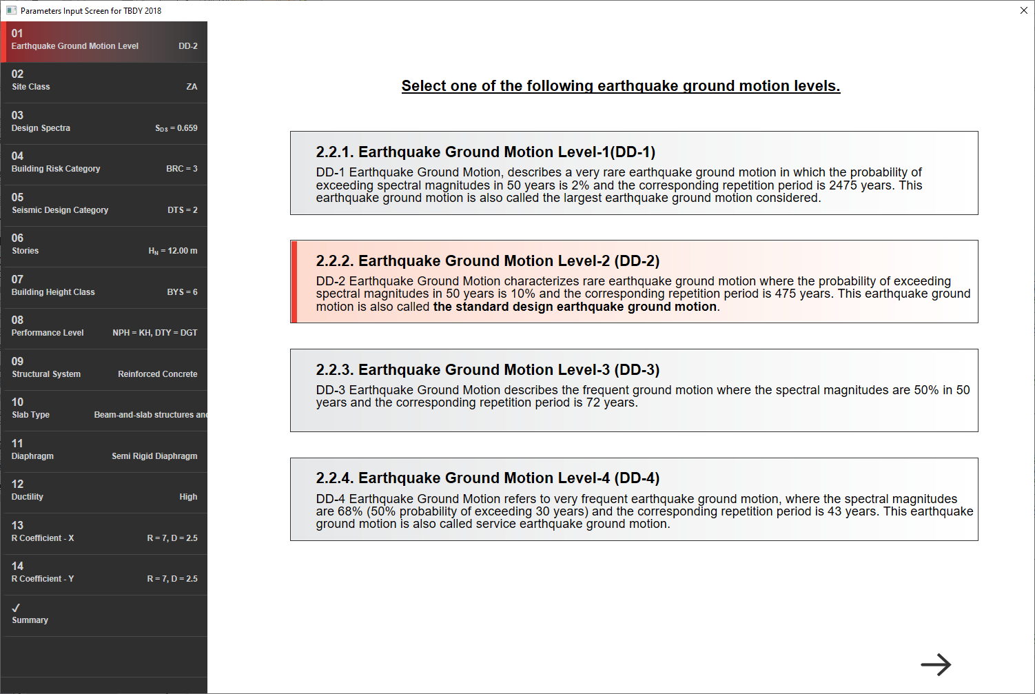

Earthquake Ground Motion Level

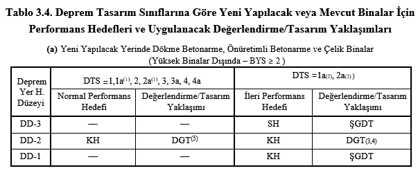

Select the earthquake ground motion level that you will determine from Table 3.4 according to the earthquake design class (DTS) of your building from the list given.
For example, if you build a new residential building, DD-2 earthquake ground motion level should be selected.
