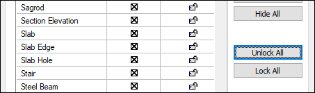

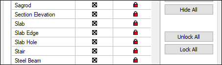

To lock all layers at once;
  • Click the Lock all button in the layer settings dialog.
  • All your unlocked layers will be locked.
To unlock all layers at once;
  • Click on the Unlock all button in the layer settings dialog .
  • All your locked layers will be unlocked.

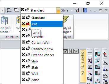

It is possible to lock and unlock a layer without entering the layer settings dialog. You can do this from the layer list in the toolbar.
  • Open the layer list by clicking the down arrow button on the right of the layer box in the toolbar with the left mouse button.
  • Click the lock sign in front of the layer to be turned off.
  • When you click on the drawing area and return to the drawing, the corresponding layer is locked. You can also unlock a locked layer in the same way.

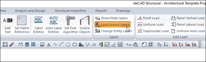

To lock or unlock objects on the same layer in the drawing area at once;
  • In the Ribbon menu, click the Lock/Unlock Layers icon in the Modify tab.

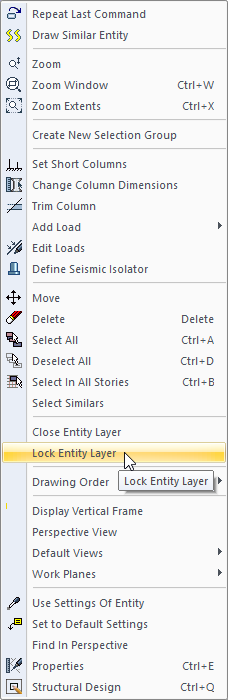

You can also lock it from the right-click menu.
  • Move your mouse over the object whose layer you want to lock.
  • Click on the right button.
  • In the menu that opens, click Lock Entity Layer.
  • The layer with the object will be locked.

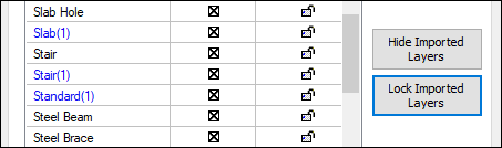

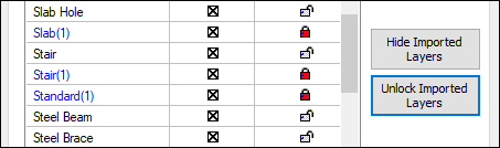

You can also lock and unlock the layers of the imported drawings at once.
  • Click the Lock imported layers button in the layer settings dialog .
  • The layers of the imported drawings will be locked.
  • You can unlock locked layers by clicking the Unlock imported layers button.
