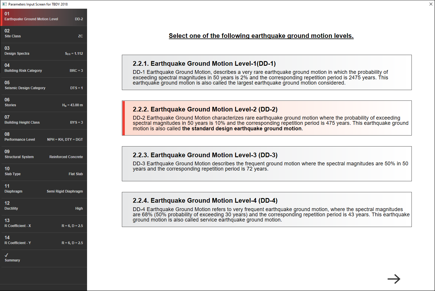

Seismic Code Wizard Steps :
Selecting Earthquake Ground Motion Level -
Site Classes -
Horizontal and Vertical Elastic Design Response Spectra -
Selecting Risk Category of Building and Importance Factors -
Seismic Design Category (SDC) -
Story Elevations -
Determination of Performance Target -
Selecting Structural System -
Selecting Slab Type -
Selecting Diaphragm Type -
Selecting Ductility Level -
Design Coefficients and Factors for X Direction -
Design Coefficients and Factors for Y Direction
With the analysis settings wizard developed by ideCAD, the seismic code parameters required for analysis and design are displayed sequentially. On the wizard screen, the ground motion level, site class, design response spectra, building risk category, performance level, structural system type, slab type, ductility level and design coefficients and factors to be used for x and y directions are displayed in order definable.

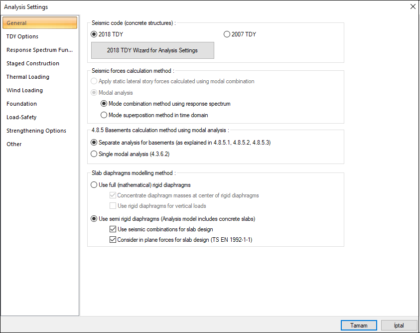

ASCE 7-16 Analysis Settings Wizard can be run from Analysis settings.
The wizard is run by clicking the ASCE 7-16 Analysis Settings Wizard icon.
Clicking the Forward Arrow button at the bottom of the wizard screen will switch to the next step. Clicking the Back Arrow button will move to the previous step.
