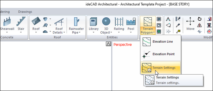

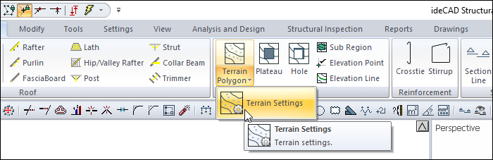

Location of the Terrain Settings Dialog
In the Architectural Program
You can access it under the ribbon menu Home tab Terrain title.
In Structural Program
You can access it under the ribbon menu Objects tab Terrain title.

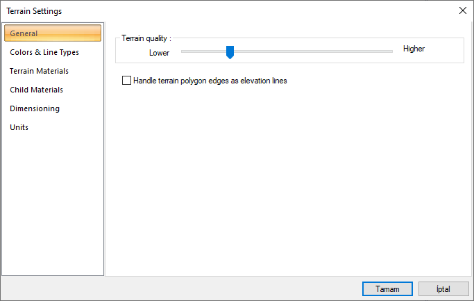

General Tab
Terrain quality
It is the indicator that determines the detail level of the terrain. A more detailed terrain drawing is created with the pointer drawn from left to right. You can adjust the pointer to a level that will give the optimum performance according to the hardware power of your computer.
Handle terrain polygon edges as elevation lines
It linearizes the slopes of the terrain lines whose elevation is between different nodes.

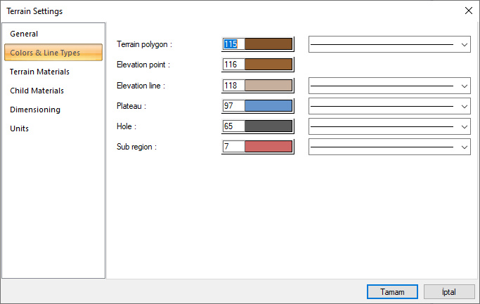

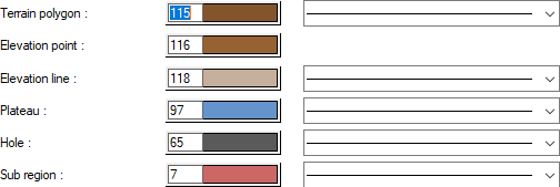

Color and Line Types Tab
You can determine the color and line types of the polygon, elevation point, elevation line, plateau, hole and sub region elements respectively by clicking the list.

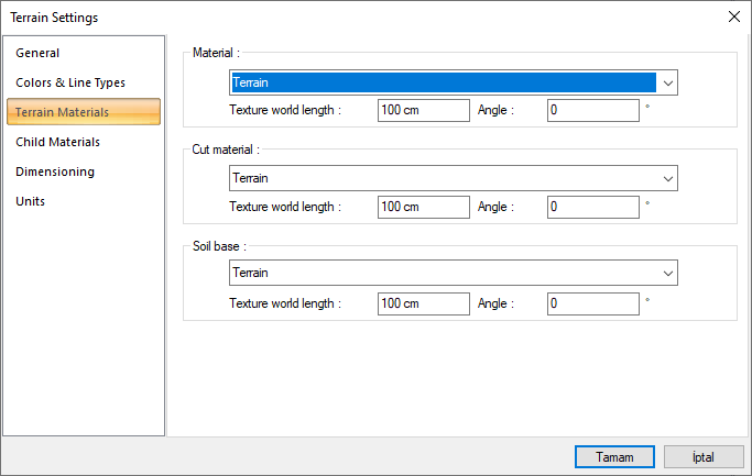

Terrain Materials Tab
Material
You can select the terrain top material from the list by clicking.
Cut material
You can select the material of the cut surfaces from the list by clicking.
Soil base
You can select the soil base material from the list by clicking it.
Texture world length
Texture length is entered. For example; If 1 meter is entered, the selected material texture is taken as 1 meter and covered on the selected object. Considering that the texture is in the form of a square, the object surfaces are covered with 1x1 textures arranged side by side.
Angle
The angle of the texture is given. With the angle value, you can adjust the angle of the texture according to the direction of its plane.

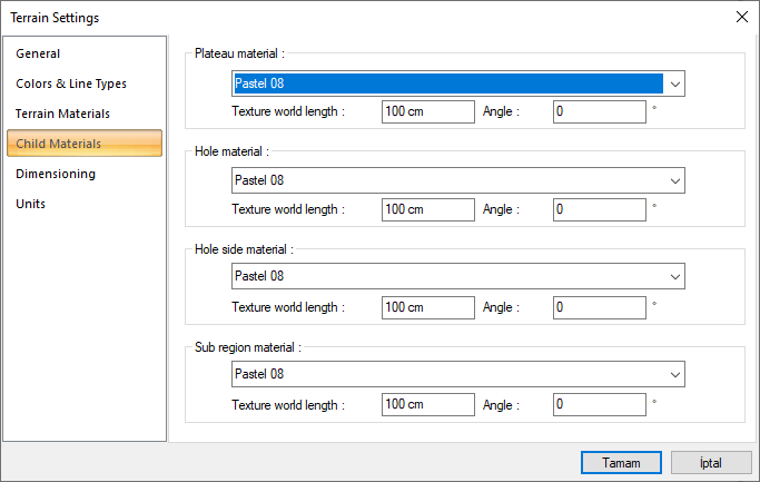

Child Materials Tab
Plateau material
You can select the material of the plateau surfaces from the list by clicking.
Hole material
You can select the material of the hole surfaces from the list by clicking.
Hole side material
You can select the material of the hole side surfaces from the list by clicking.
Sub region material
You can select the material of the sub region surfaces from the list by clicking.
Angle

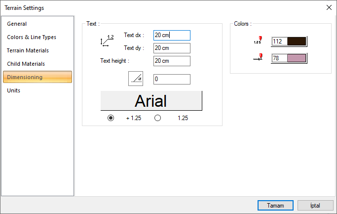

Dimensioning Tab
Text dx/dy
It is the x/y coordinates that determine the location of the section elevation text on the section line.
Font height
It is the writing height of the elevation text.
Angle
It is the angle of the elevation writing.
Font
Clicking it opens the font dialog. The font of elevations text is selected in the dialog.
Display type
Select the display format of the elevation positive value.
Colors
The colors of the elevations text and line are adjusted. In addition, if the box is clicked with the Shift key, the pen thickness of the relevant color can be adjusted.

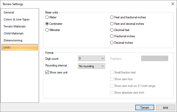

Units Tab

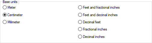

Basic units
One of the selections is activated by clicking the left mouse button on the job.
Meter : If checked, the unit of information text will be meters.
Centimeter : If checked, the unit of the callout will be centimeter.
Millimeter : If checked, the unit of callout will be millimeter.
Feet and fractional inches : If checked, the unit of callout is feet and fractional inches. The unit format is, for example, 15 '-10 3/4 ".
Feet and decimal-digit inches : If checked, the unit of callout is feet and decimal-digit inches. Unit format is, for example, 15' -10.7".
Decimal place fit: If checked, the unit of callout will be decimal place fit. The unit format is for example 15.89 '.
Fractional inch: If checked, callout unit will be fractional inch. The unit format is, for example, 1901/2 ".
Inch with decimal places : If checked, the unit of callout is inches with decimal places. The unit format is for example 190.7".
Digit count
It determines how many digits will be shown after the comma. The desired number is selected from the list. For example, if 2 is selected, units will be shown as two digits after the comma. If 0 is selected, units will not be shown after the comma.
Fractions
It determines the precision of the dimension to be made in fractional inch format. In the list, there are options with a sensitivity of 1/2, ¼, 1/8, 1/16, 1/32, 1/34. If "no fraction" is selected, units will appear without fractions.
Rounding interval
It determines the rounding range of the measurement to be made in meters, centimeters or millimeters. If No rounding is selected, the dimensioning is done at exact value. As the range gets larger, the dimensioning is rounded up to the selected range.
Show zero unit
If it is not checked, it does not show the zero and point on the left in dimensioning. For example, it measures 0.20 as 20. If marked, the value 0.20 is scaled as 0.20.
Show zero foot
Determines whether 0 is displayed in the 0-foot gauge (less than 1 foot gauge). For example, if it is not checked, it will show a measure of 0 '- 15 "as -15". If marked, it shows as 0'-15 ".
Show zero inch on 0-1 inch range
For example, a dimension inch with a value of 8'-0 1/6 "is in the range 0-1. If the option is not ticked, the value 8'-0 1/6" will be displayed as 8'-. In other words, inch values ​​in the 0-1 range will not be displayed.
Show absolute zero inch
Determines whether to show zero inches in the dimension value where inches is absolute zero. For example, a dimension of exactly 10 'will be displayed as 10'-0 "if this option is selected. If not checked, it will be displayed as 10" -.
Small fraction text
When fractional inch format is selected, determines the fractional part to display in upper / lower case. If it is checked, the fraction is slightly above the integer and small, if not, the fraction is shown the same size next to the integer.
