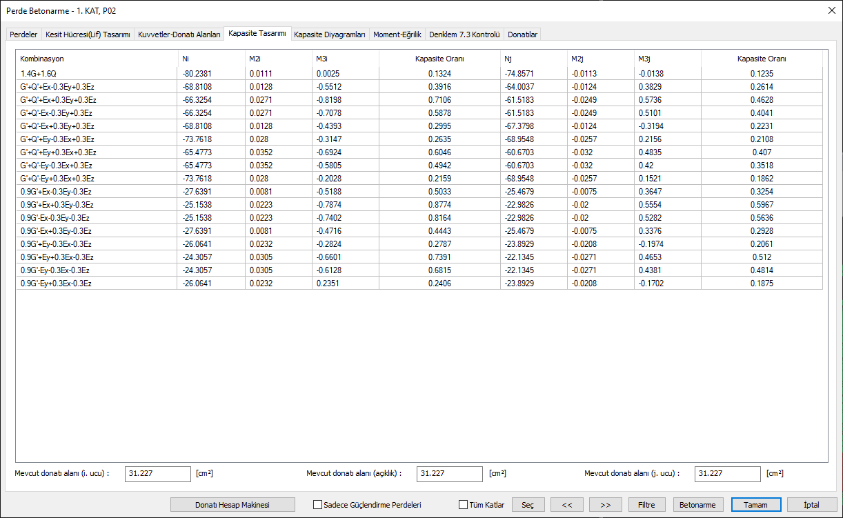

There are shearwall groups that do not meet the capacity ratio.
Group curtain Capacity Design Ratios are given in curtain reinforced concrete.
This message is given for group curtains with Capacity Ratio> 1. The curtain group capacity ratio should be <1.
Possible solutions:
  • The thickness of the curtains or the length in the plan can be increased to the curtain group.
  • Curtain head area reinforcements can be increased.
After the procedures, the analysis should be repeated.
