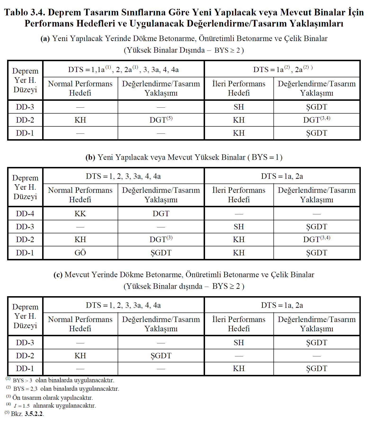

Normal Performance Targets defined for Earthquake Design Class DTS = 1, 2, 3, 3a, 4, 4a according to TBDY 3.5.1 and Advanced Performance Targets defined for Earthquake Design Class DTS = 1a, 2a are defined in Table 3.4 . Table 3.4 't Earthquake Design Class ' by the Solidarity by Design (DOT) to approach or by Strain Evaluation and Design (ŞGDT) approach shown by a performance target solution made with.

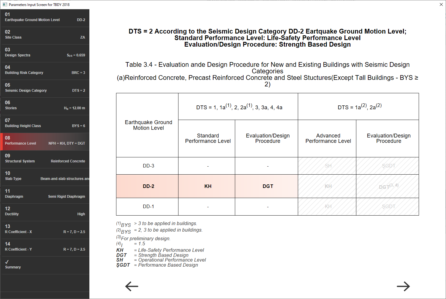

In the earthquake calculation made considering the conditions defined in Chapter 4 , the performance target is Controlled Damage (KH) and Design Based on Resistance (DGT) approach is applied using DD-2 earthquake ground motion level .
The rules defined in Chapter 5 and Chapter 15 should be applied in the Evaluation and Design According to the Shape (CSDT) approach .
Using the TBDY 2018 Analysis Settings Wizard , the performance target and the evaluation / design approach are automatically determined in accordance with Table 3.4 .
