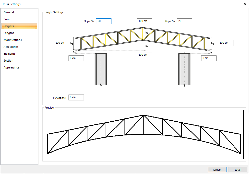

You can access the Truss Settings dialog by clicking the Settings icon from the Trusses toolbar that opens when the Truss command is clicked. Truss pattern type and count settings are available on the Heights tab.
  • Click the Truss icon in the ribbon menu .
  • The trusses toolbar will open. Here Settings , click the icon.
  • The Truss Settings dialog will be displayed. Here Height of the tab.
Heights Tab
h1
It is the value that determines the height of the truss on the left slope.
h2
It is the value that determines the height of the truss on the right slope.
h3
It is the value determining the height of the bottom point of the truss.
h4
It is the value determining the height of the top of the truss.
h5
The floor is the value that determines the height of the truss right end from the base.
h6
The floor is the value that determines the height of the left end of the truss from the base.
