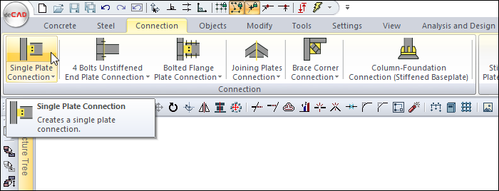

Location of the Single Plate Connection Command
  • From the Connection menu, click the Single Plate Connection icon.

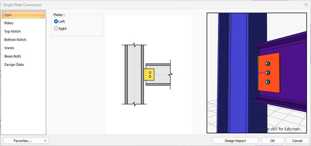

Type Tab
Plates
It is chosen whether the plate will be on the left or right of the beam body.
The connection is shown on the schematic drawing.

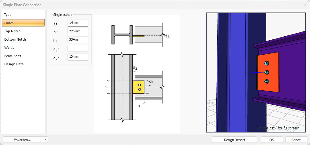

Plates Tab
Single plate

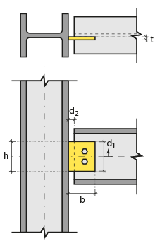

The properties of the plate are determined by entering the values. The values ​​to be entered are shown in the schematic drawing.
There is a preview of the combination. The selection made and the entered values ​​can be followed simultaneously in the preview.

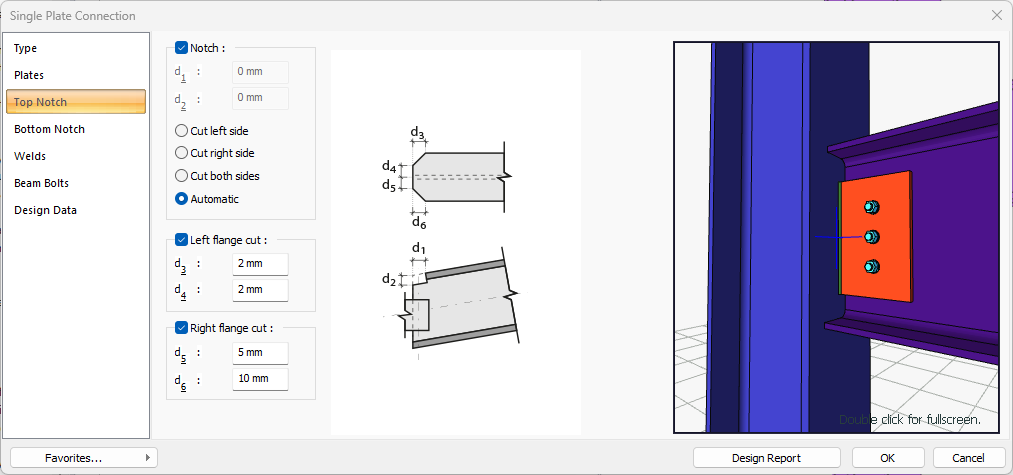

Top/Bottom Notch Tabs
Notch
If the option is selected, notching is done according to the entered values ​​and selections. The values ​​to be entered are shown in the schematic drawing.
Left flange cut
If the option is selected, left flange cutting is made according to the entered values. The values ​​to be entered are shown in the schematic drawing.
Right flange cut
If the option is selected, right flange cutting is made according to the entered values. The values ​​to be entered are shown in the schematic drawing.
Joining, notching and cutting values ​​are shown on the schematic drawing.

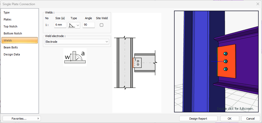

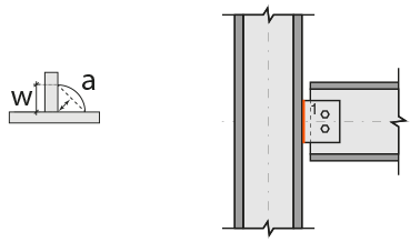

Welds Tab
In the Welds tab, the weld properties of the joints given in the schematic representation are set.
Welds
Weld electrode
The strengths of the welding electrodes are defined in the design inputs. The strength of the main element in the weld connection is controlled under the condition that it has less strength than the weld strength.
To create the welding electrode, provide the information "Name" and "Weld metal tensile strength" in the dialog that opens after clicking "Create New".
Welding geometry is determined automatically by the program. These properties can be changed to easily determine the joint properties. Geometry features are in accordance with industry standards and in the form specified in AISC.
Connection and welds values ​​are shown on the schematic drawing.

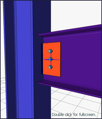

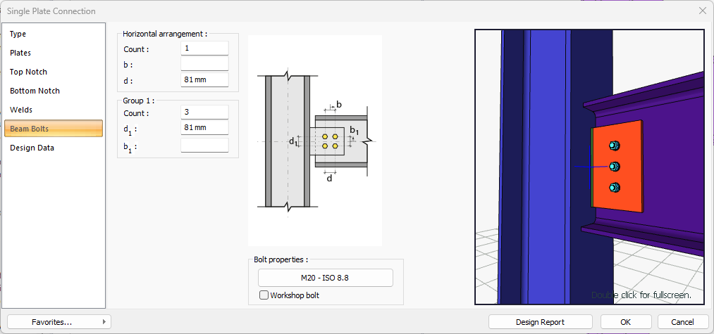

Beam Bolts Tab
Horizontal arrangement
Horizontal arrangement settings (number of horizontal bolt columns, distance values ​​..) of beam bolts are entered. The values ​​to be entered are shown in the schematic drawing.
Group 1
Beam bolts settings (number of lines, distance values ​​..) are entered. The values ​​to be entered are shown in the schematic drawing.
Bolt properties

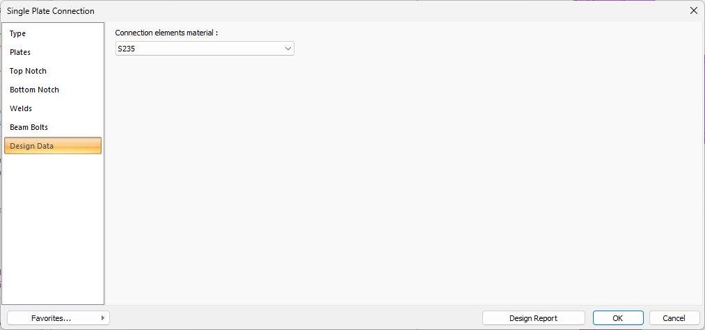

Design Data Tab
