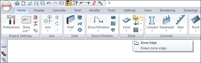

Ribbon menu Home tab Zone under the heading located, after entering the Zone Edge command opened Zone Edge can be accessed from the toolbar.
  • Click the arc zone edge command.

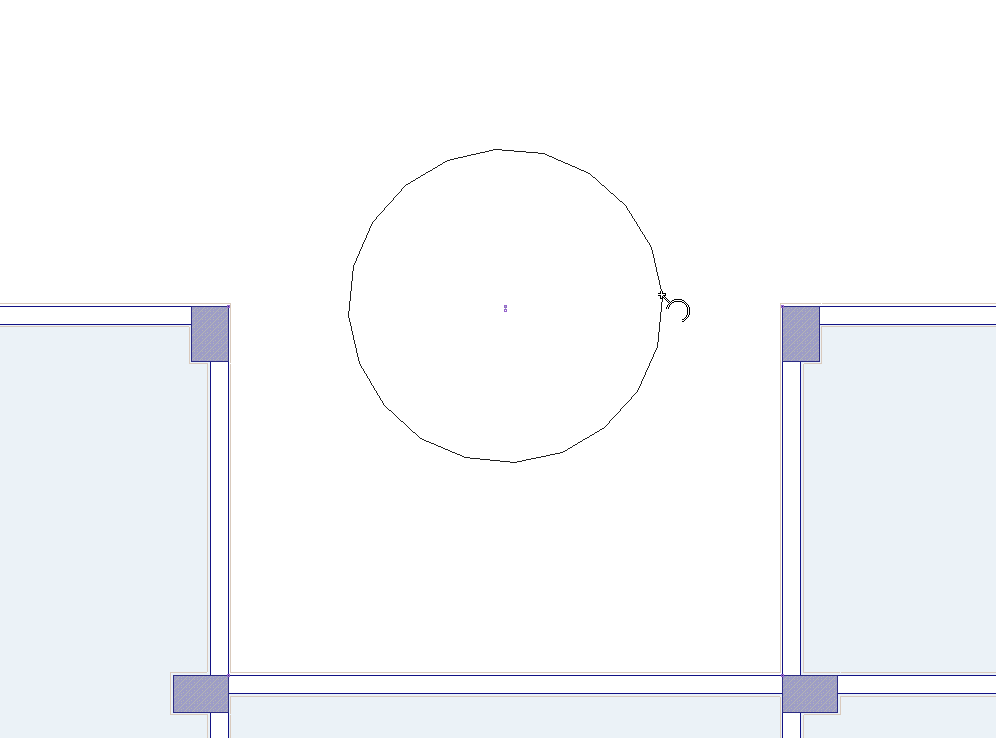

  • When you move the mouse, a circular form will appear at the tip of the cursor.

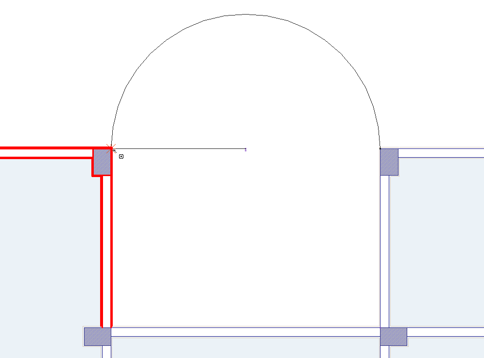

  • Create the starting point of the arc zone edge by clicking the left mouse button.
  • Drag the mouse after clicking. The arc will change depending on the mouse movement.

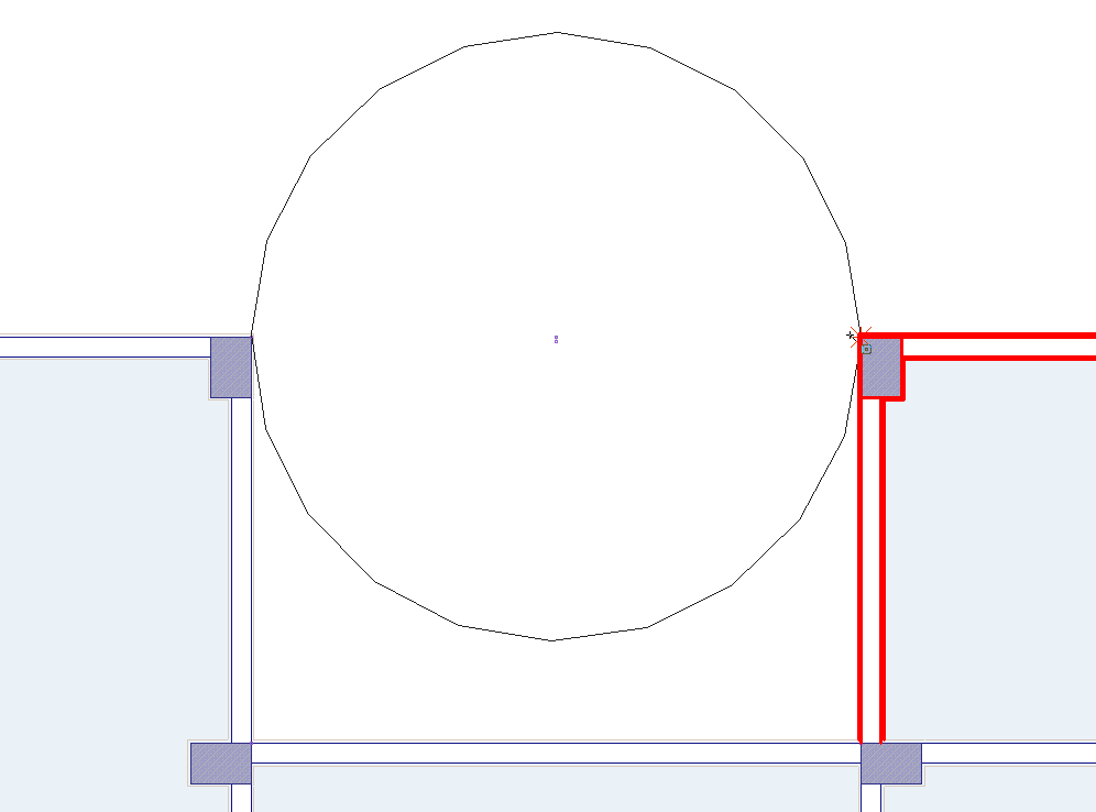

  • Determine your second point where the edge of the zone will end and click the left mouse button.

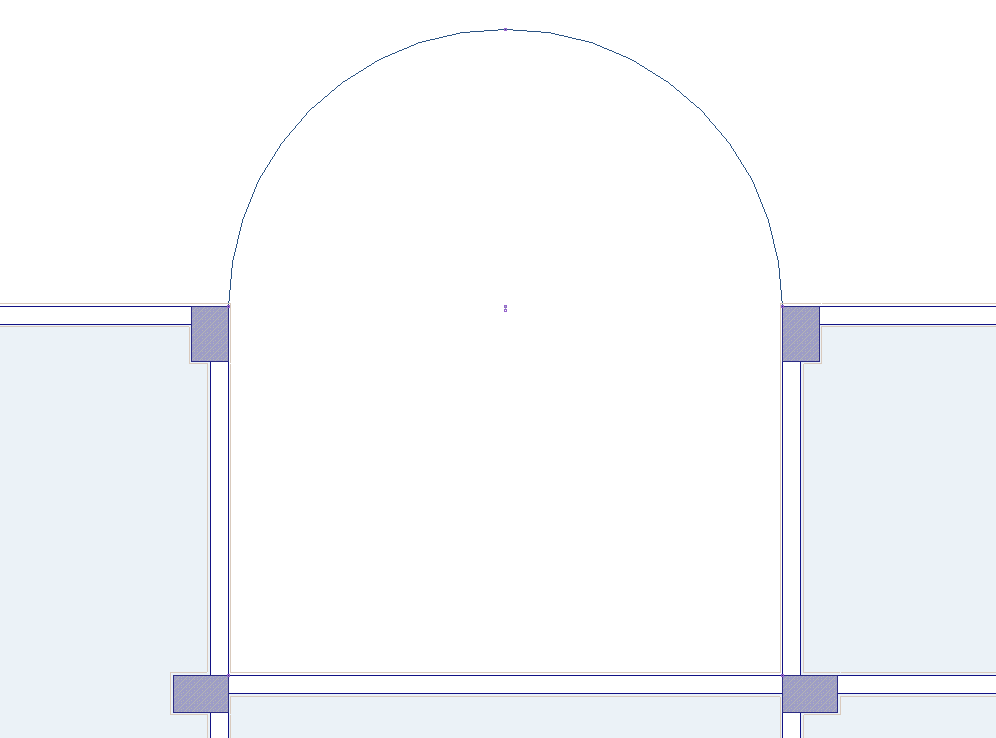

  • Your arc zone edge will be formed.

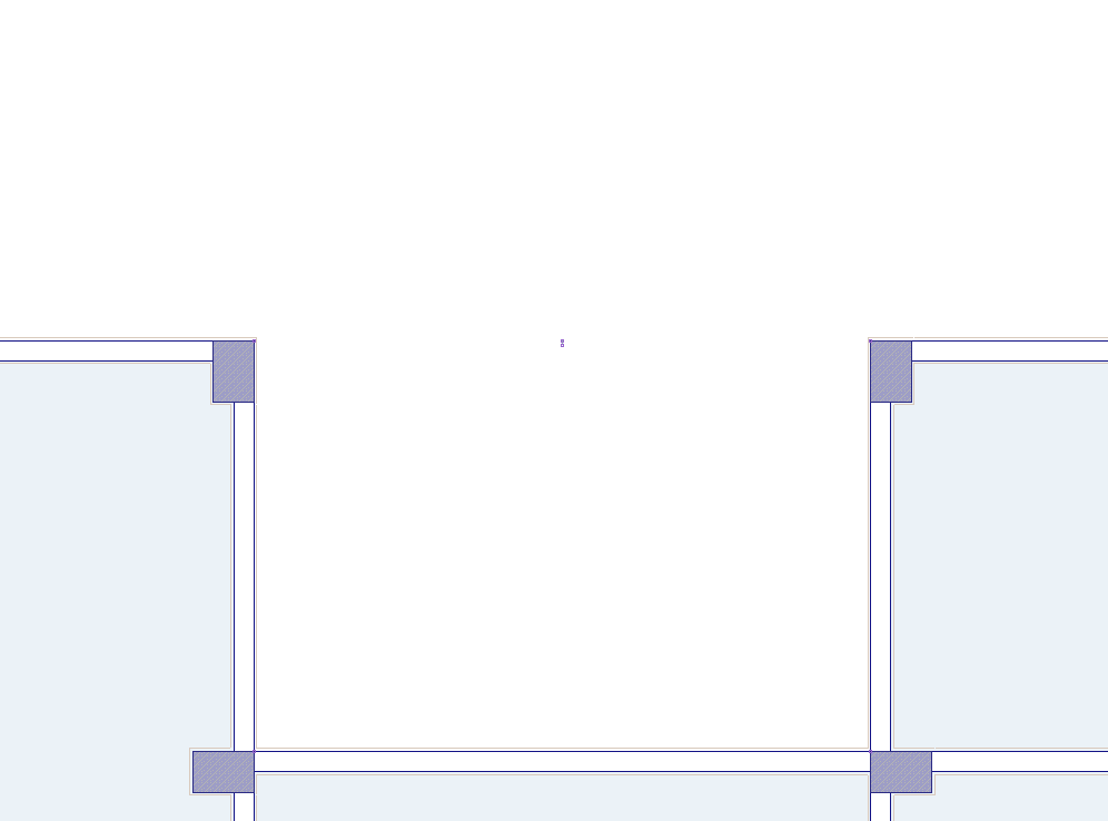

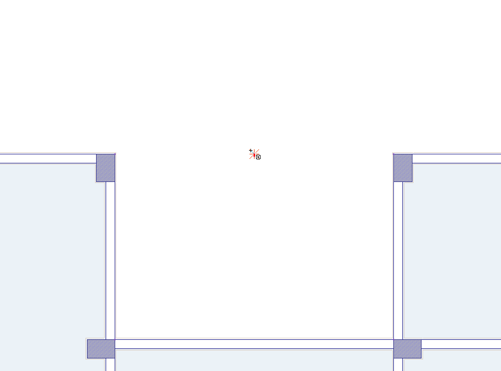

The area to be drawn arc zone edge
Determining the center of the arc area edge

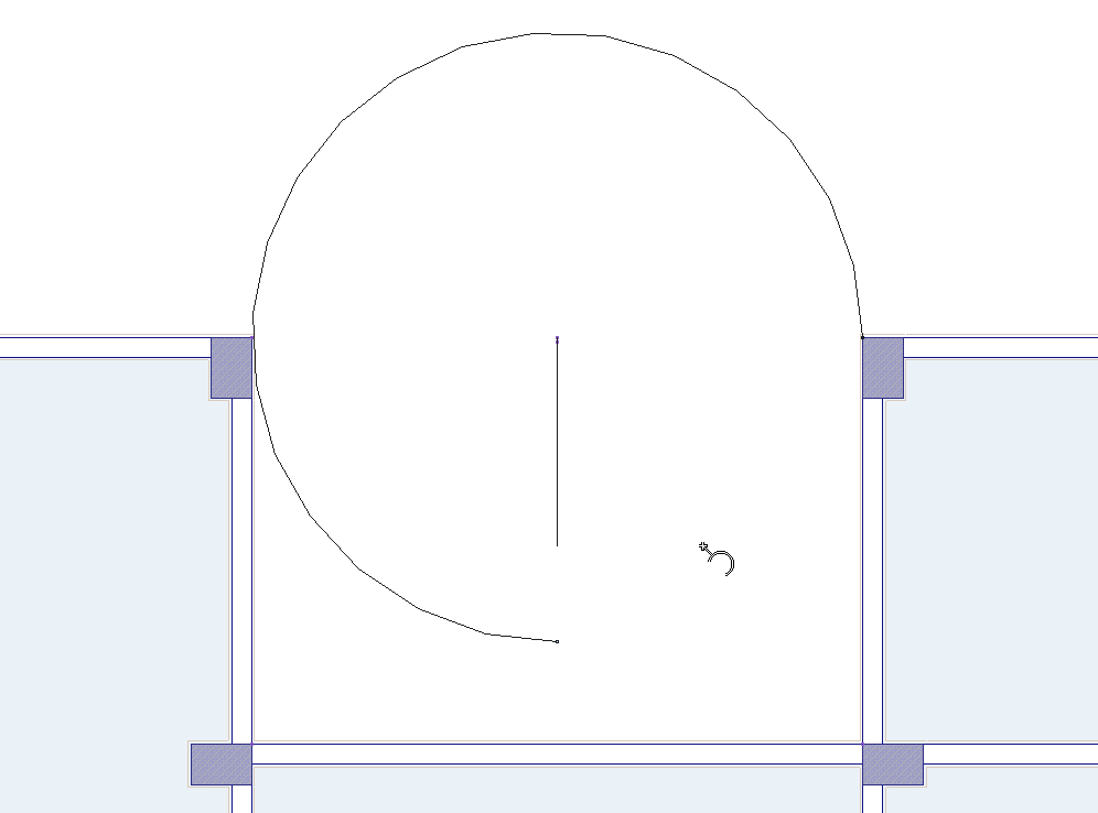

Creation of circular form preview
Creating the starting point of the arc area edge by clicking the left mouse button
Change of arc zone edge depending on mouse movement
Determining the second point where the zone edge will end
Formation of arc zone edge
