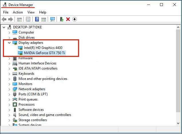

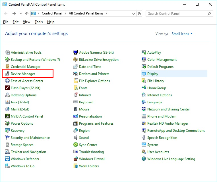

  • Check the status of your video card in Control Panel / Device Manager icon.
  • Check the status of your video card in the Display Adapters section.
  • If you see an open supported video card here, then the driver of your card may not be installed or the onbord video card may be active.
  • Update your computer's video card driver and run the program with a high performance video card.

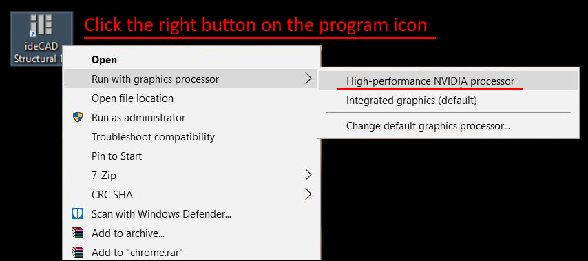

To run the program with a high performance graphics card;
  • Click the right mouse button on the program shortcut on the desktop.
  • Run by selecting the "Run with graphics proceesor/High-performance graphics processor" option in the menu that opens.
