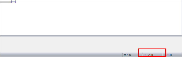

Clicking the down arrow button opens the list showing the numbers 20, 50, 100, 200, 500. The drawing will be scaled according to the selected figure. For example, if the scale value is 50, the view scale will be 1/50. If the OK button is clicked and the dialog is exited, which scale is valid is indicated in the lower right corner of the program. Next to the scale value, information is given at which zoom factor this scale is valid. Drawings will appear at 1/50 scale, 100% zoom factor, unless the user zooms in. Being at 100% zoom factor means that object lengths can be measured exactly with the 1/50 technique. When zooming at any time, the zoom scale will naturally change.

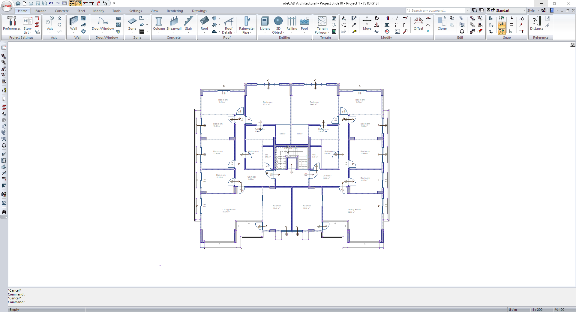

When the scale is 1/200

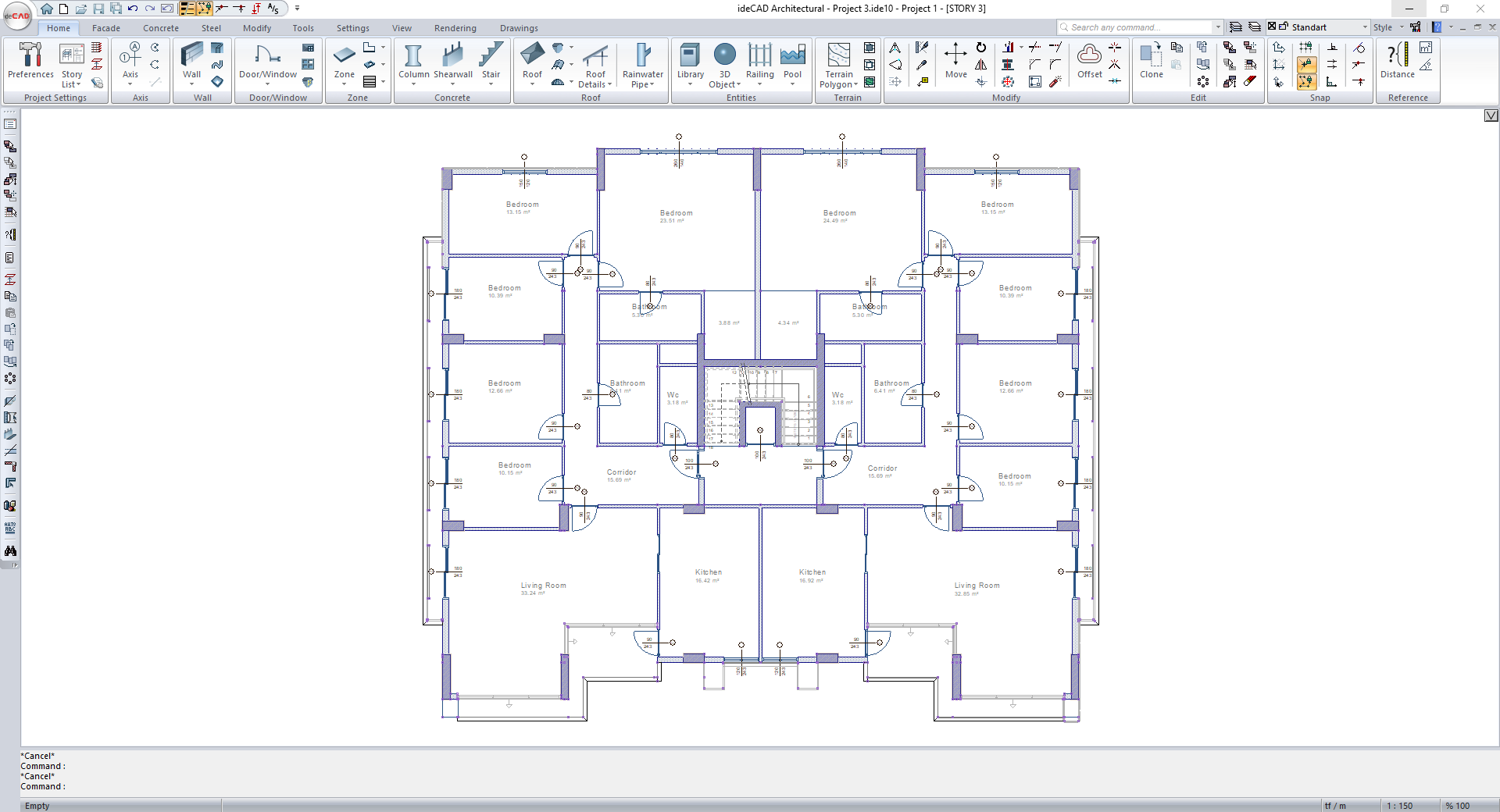

When the scale is 1/150

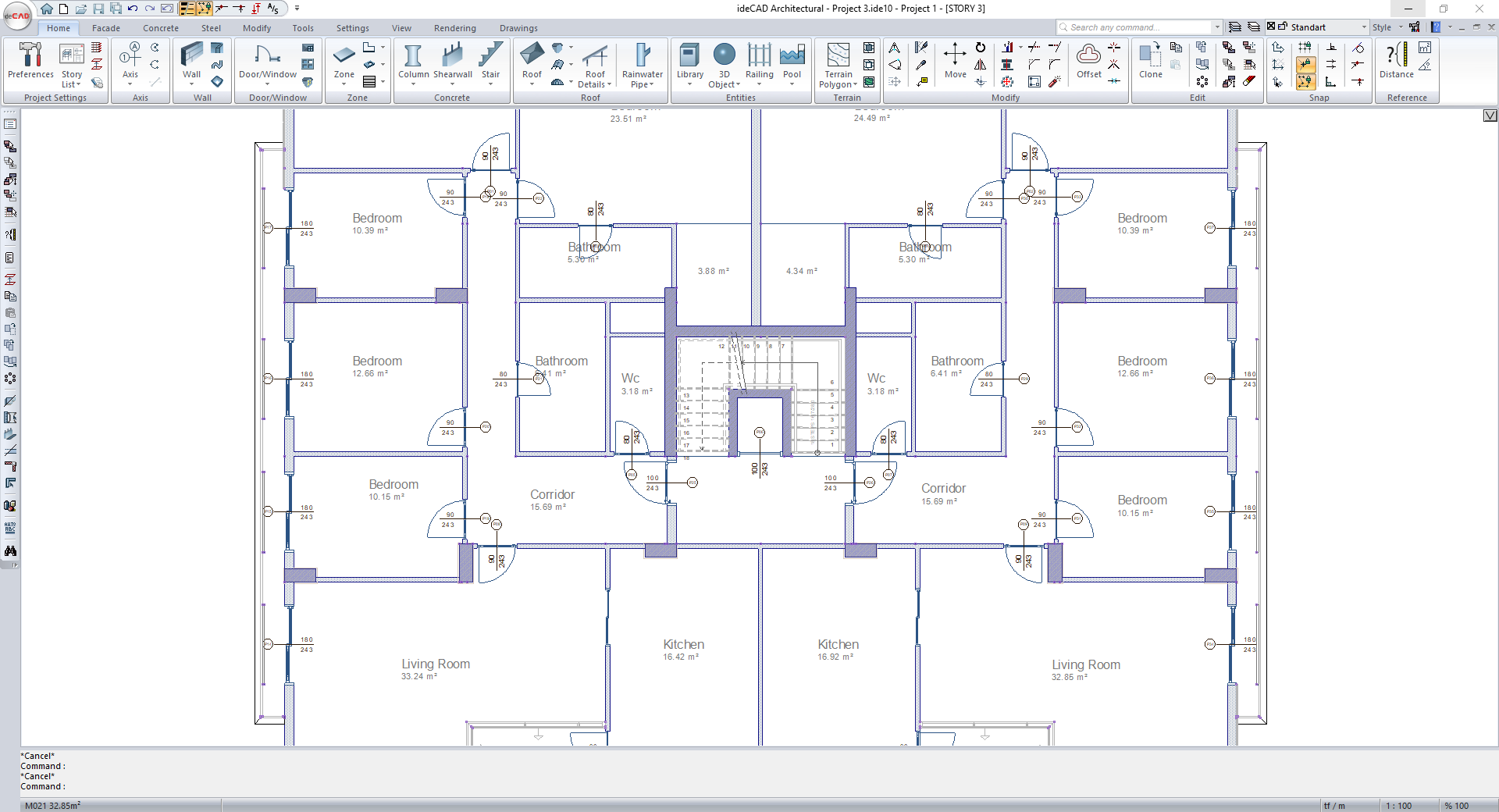

When the scale is 1/100

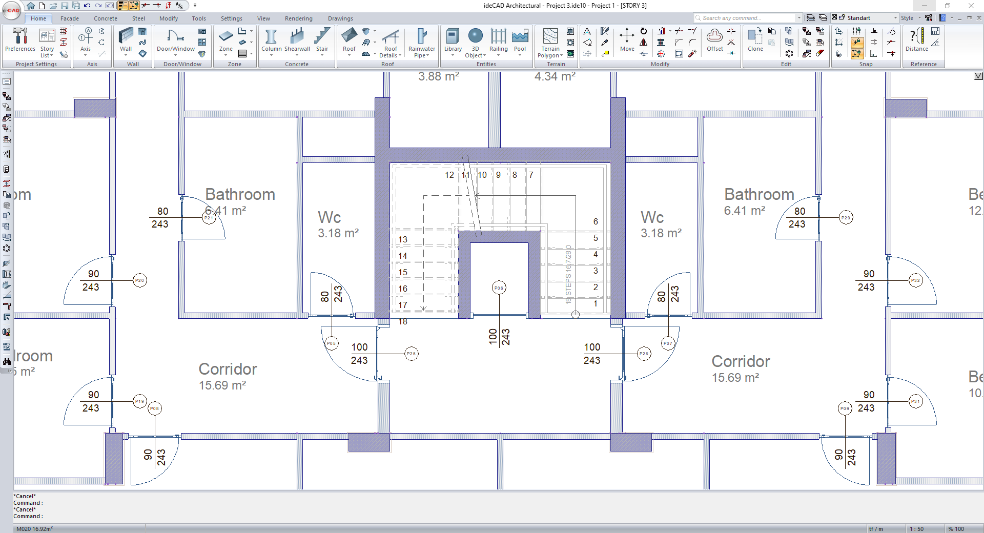

When the scale is 1/50
