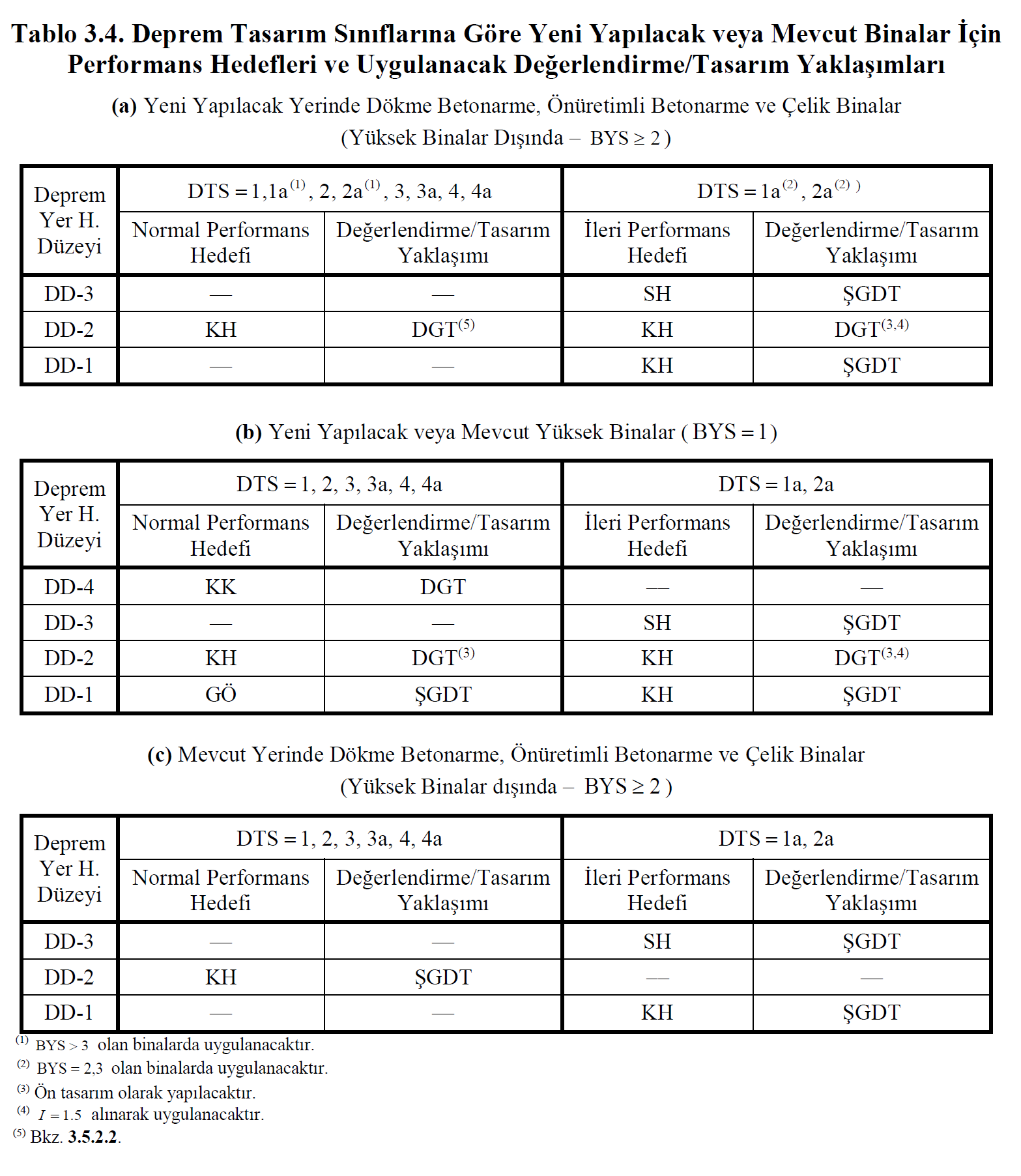

For the four earthquake ground motion levels defined in 3.5.1.1 - 2.2 , Earthquake Design Class DTS = 1, 2, 3, 3a, 4, 4a and Earthquake Design Class DTS = 1a, to be applied to buildings within the scope of this Regulation , Advanced Performance Targets defined for 2a are given in Table 3.4 and Table 3.5 . Depending on the owner's request, further performance targets corresponding to earthquake ground motion levels in Table 3.4 can be selected.
3.5.1.2 - Masonry, wooden and light steel buildings not specified in Table 3.4 will meet the Controlled Damage (KH) performance target under the effect of DD-2 earthquake ground motion.
