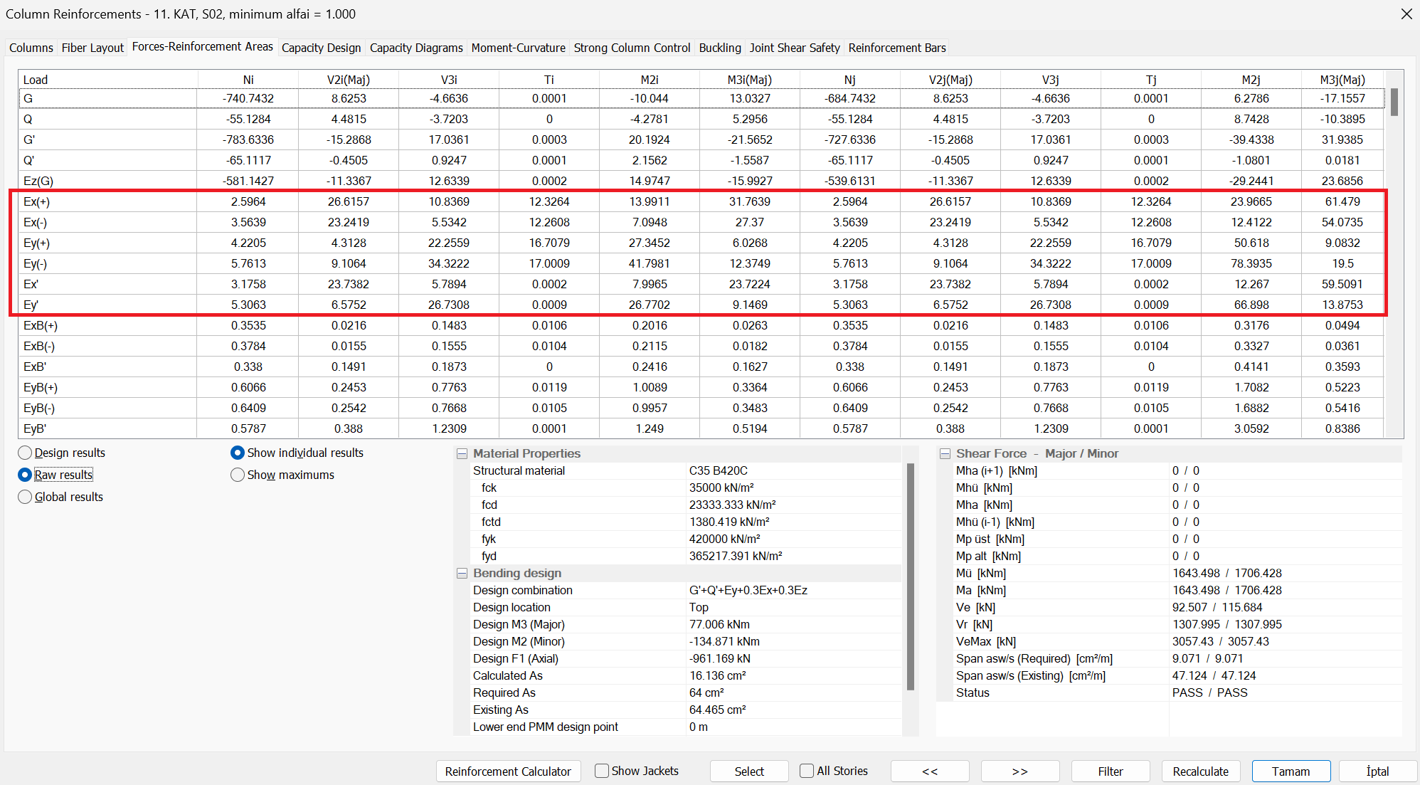

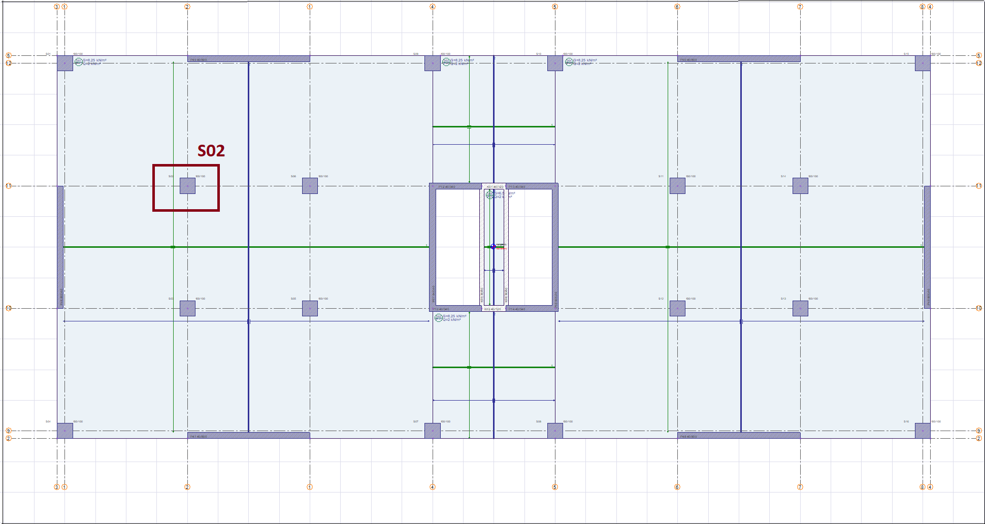

  • Internal force results of the monolithic solution for the first stage are as follows. As an example, the 11th-floor S02 column is used. In this column, which is the upper section element, only the results of the first stage are used to determine the design internal forces.

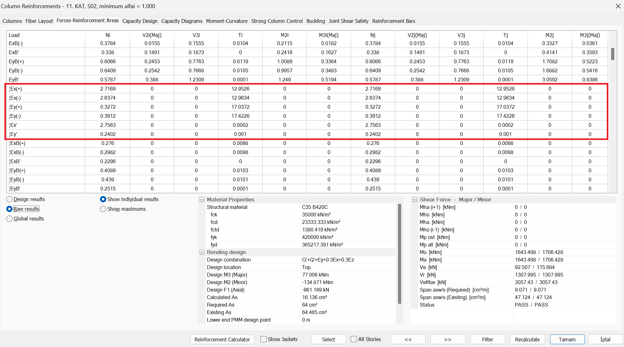

  • Results obtained from the solution where the upper and lower ends of the same column are hinged for the first stage.
  • It is seen that the shear force and moment values ​​are 0.

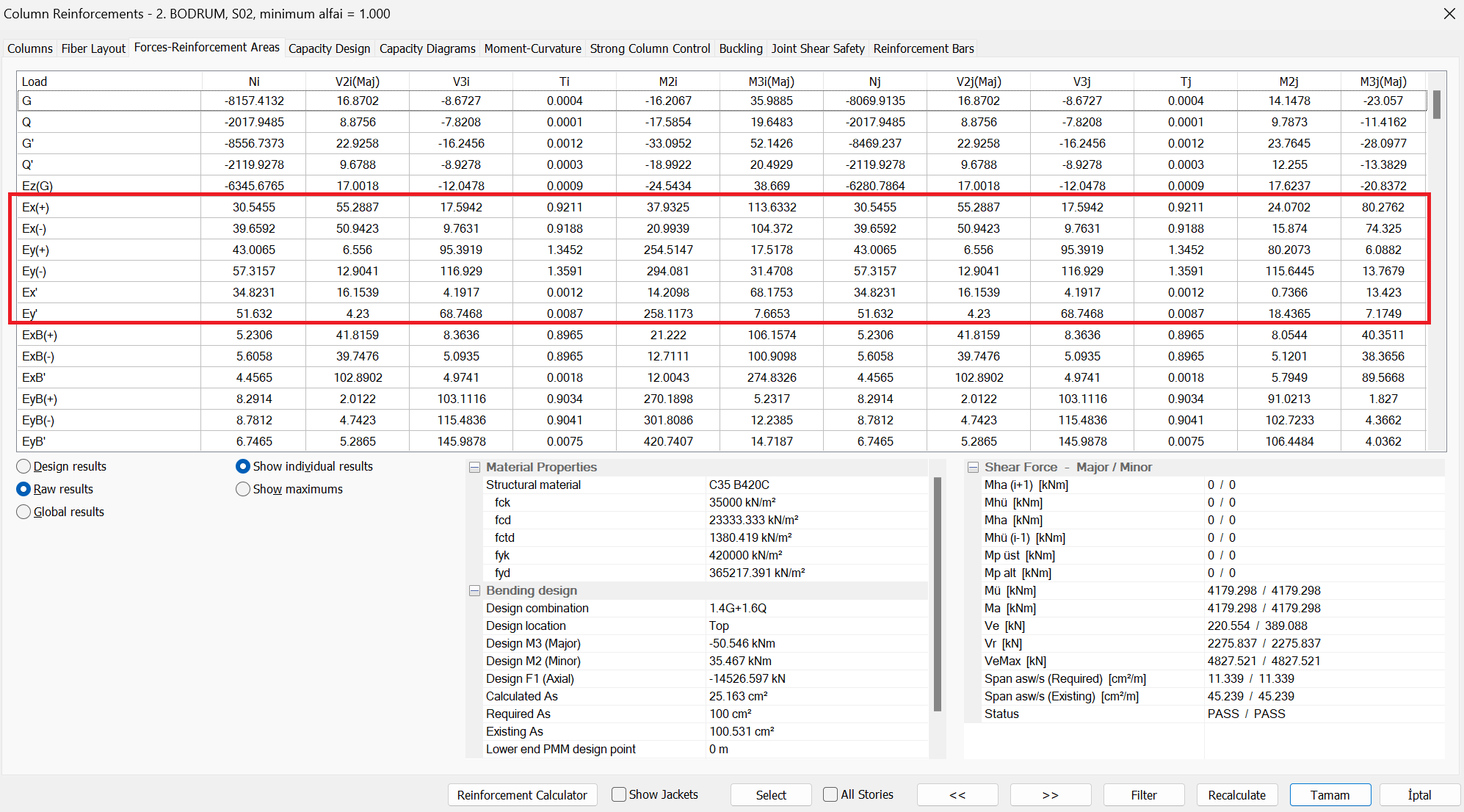

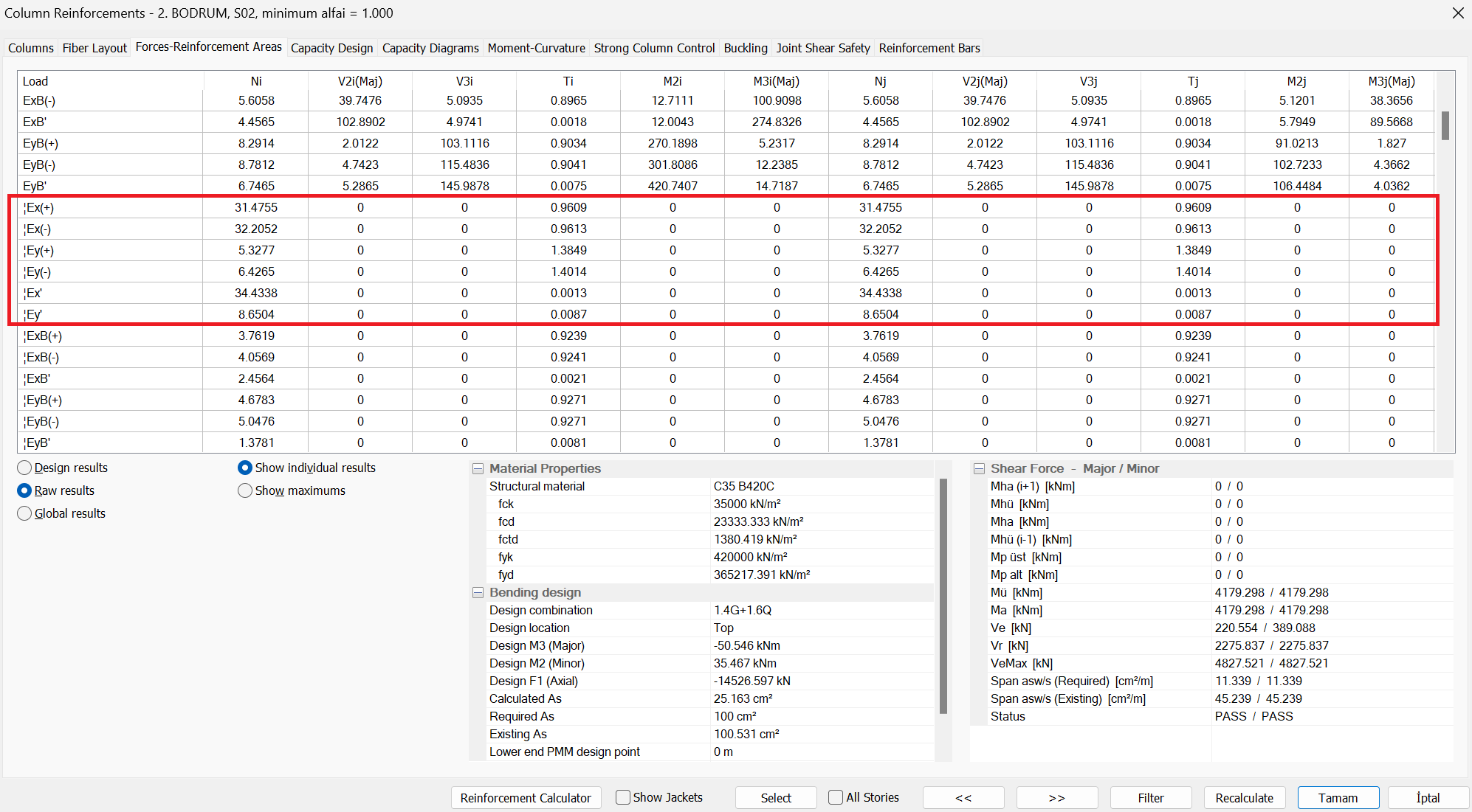

  • The upper section analysis results for the 2nd basement floor S02 column are as follows. Both the first stage and the second stage results are used to determine the design of essential internal forces in the basement floor elements.
  • This subject is detailed in the section on the calculation of internal forces based on design.
