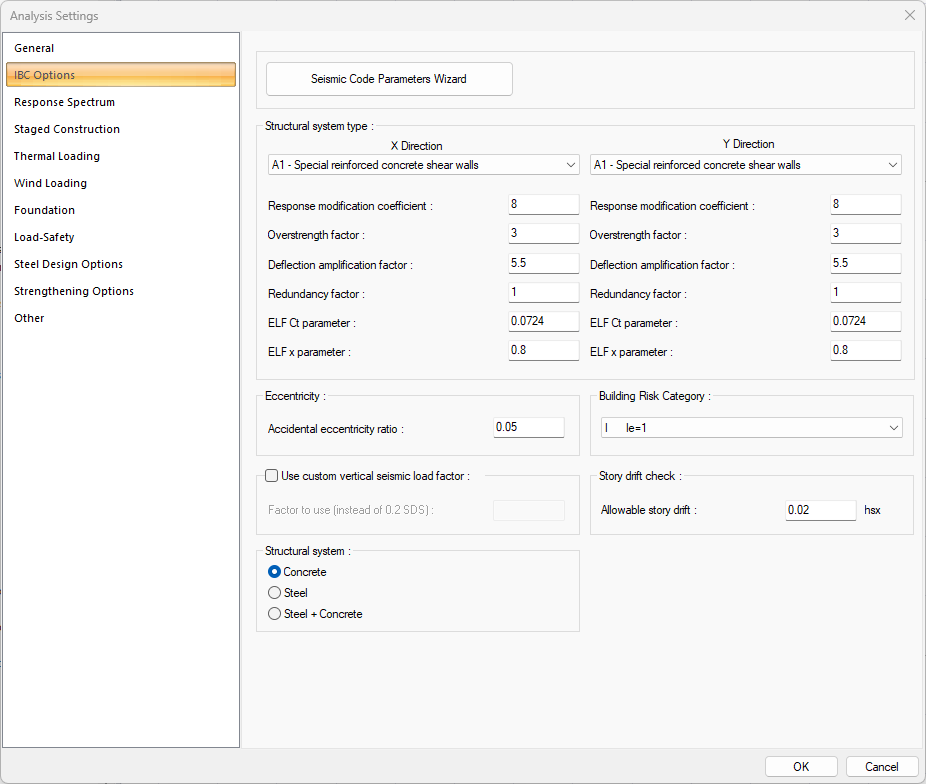

IBC Options Tab
Seismic Code Parameters Wizard
It displays the analysis settings wizard where the parameters specific to IBC are determined step by step. On the wizard screen, you can assign the site class, risk category, horizontal and vertical response spectrum, seismic design category, stories, stories, structural system, diaphragm, structural system type ​​to be used.
Structural system type
The type of structural system for X and Y direction is selected in accordance with the design of the building.
Response modification coefficient
It is the response modification coefficient value. This row is automatically refreshed when the structural system type is chosen.
Overstrength factor
It is the strength excess coefficient value. This row is automatically refreshed when the structural system type is chosen.
Deflection amplification factor
It is the deflection amplification factor value. This row is automatically refreshed when the structural system type is chosen.
Redundancy factor
It is the redundancy factor value. This row is automatically refreshed when the structural system type is chosen.
ELF Ct parameter
It is the ELF Ct parameter. This row is automatically refreshed when the structural system type is chosen.
ELF x parameter
It is the ELF x parameter. This row is automatically refreshed when the structural system type is chosen.
Accidental eccentricity ratio
The eccentricity ratio to be used during the analysis is given as a percentage.
Use custom vertical seismic load factor
If checked, the custom vertical seismic load factor which entered in "factor to use (instead of 0.2 SDS)" line is used.
Structural system
If the building block consists of only concrete elements, Concrete; if it consists of only steel elements, Steel; Steel + Concrete option is selected if it consists of concrete and steel elements.
Building Risk Category
Building risk category value is selected from the list according to the purpose of use of the building.
Story drift check
Allowable story drift value is entered.

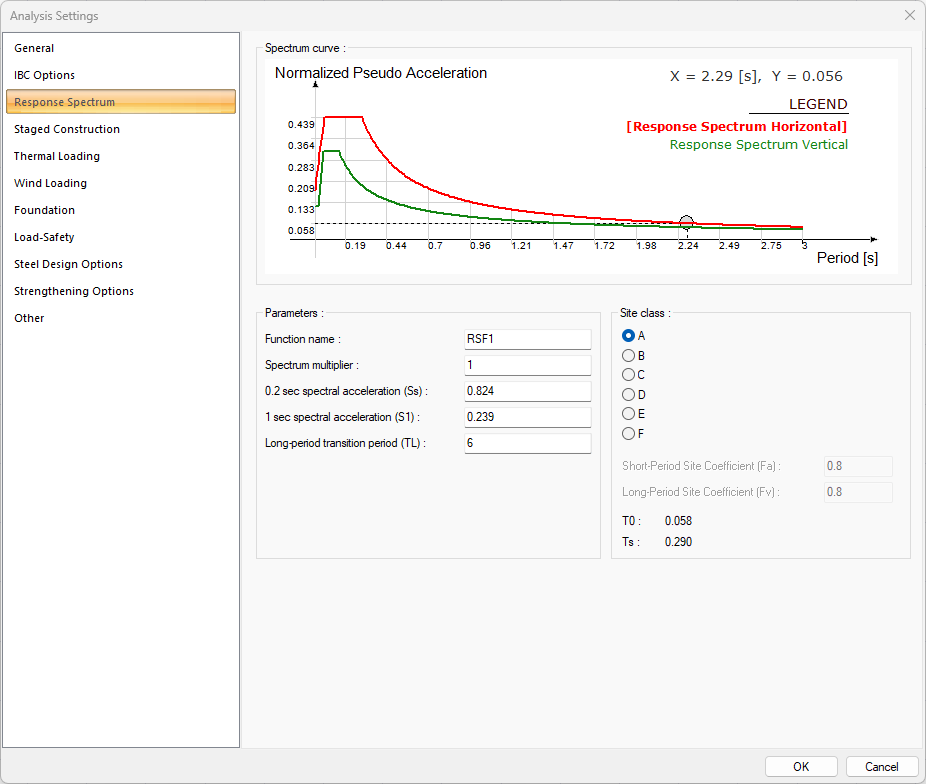

Response Spectrum Tab

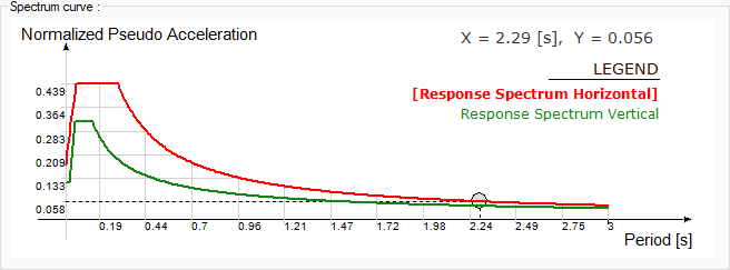

Spectrum curve
The spectrum curve resulting from the settings is shown.
Function name
The name of the spectrum function.
Spectrum multiplier
Factor of spectrum function.
0.2 sec spectral acceleration (Ss)
0.2 sec spectral acceleration of spectrum function.
1 sec spectral acceleration (S1)
1 sec spectral acceleration of spectrum function.
Long-period transition period (TL)
Long-period transition period of spectrum function.
Site class
Site class is selected.
Short-period site coefficient (Fa)
Short-period site coefficient of spectrum function.
Long-period site coefficient (Fv)
Long-period site coefficient of spectrum function.
T0/Ts
Spectrum Characteristic Periods.
