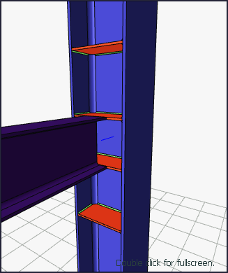

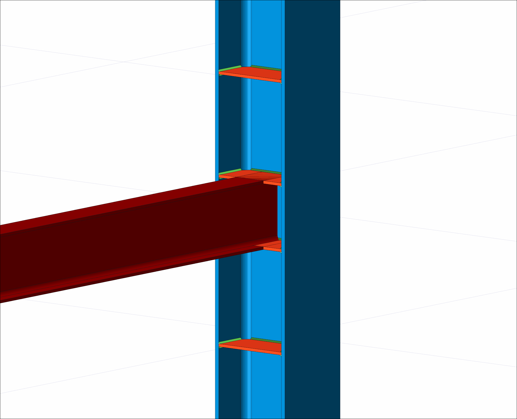

With the Quad Stiffener Plate command, stiffener plates are created according to the beam specified in the image, taking as reference the beams connected to the weak axis of the steel columns.

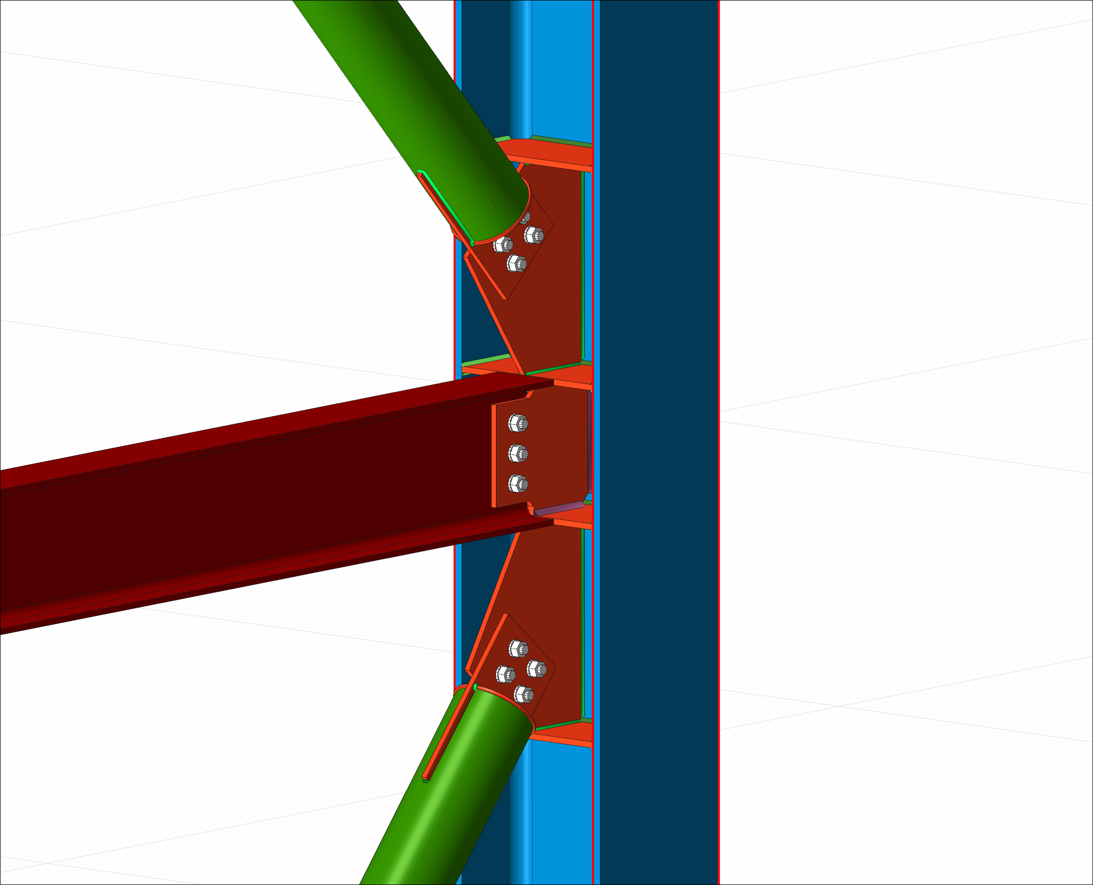

After modeling the quad stiffener plates, braces, brace connections and beam connections can be defined and a connection model can be created as shown in the image.

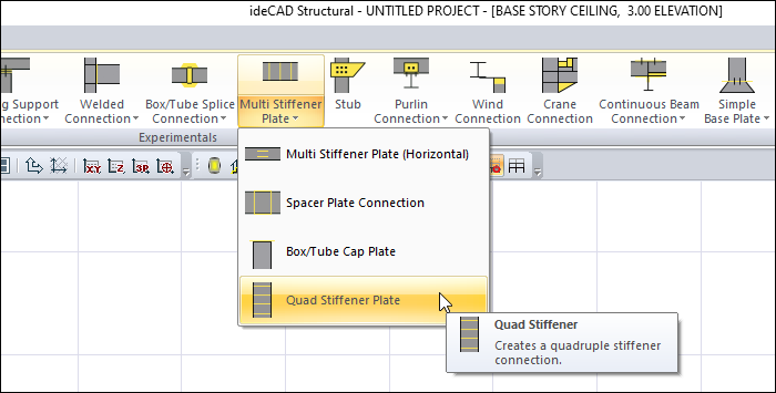

Location of Quad Stiffener Plate Command
  • From the Connection menu, click the Quad Stiffener Plate icon.
  • Click on the column and then the beam in the 3D perspective view.
  • The quad stiffener plate connection settings dialog will open.

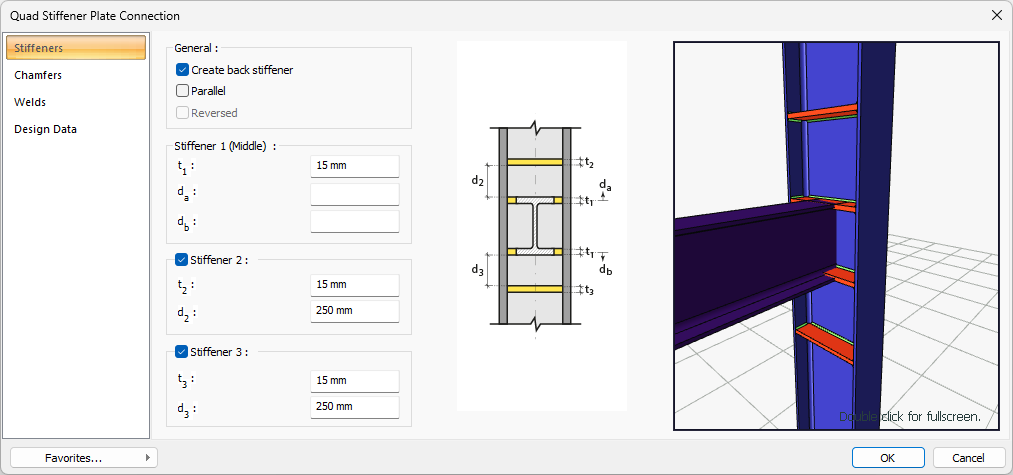

Quad Stiffener Plate Connection Settings Dialog
Stiffeners Tab
Create back stiffener
By selecting the option, stiffener plates are also created behind the column.
Parallel
By selecting the option, the stiffener plates in the angled columns are created parallel to the beam.
Reversed
By selecting the option, the direction of the stiffener plates is determined. When the create back stiffener is marked, it becomes inactive.
Stiffener 1
The thickness of the stiffeners at the beam level and the distances between them and the beam are determined by entering the value. The values ​​to be entered are shown in the schematic drawing.
Stiffener 2
While the command is active, the thickness of the reinforcement plate on the upper side of the beam and its distance from the other reinforcement plate are determined.
Stiffener 3
While the command is active, the thickness of the reinforcement plate at the bottom of the beam and its distance from the other reinforcement plate are determined.

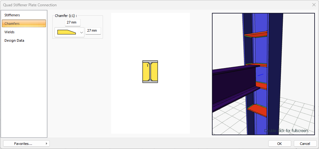

Chamfers Tab
Chamfer (c1)

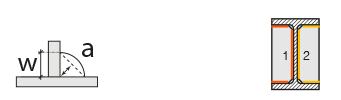

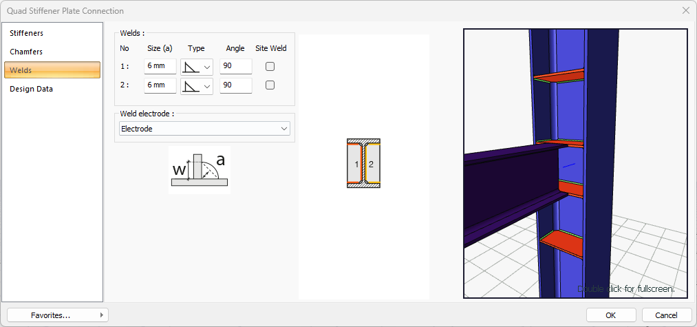

Welds Tab
Welds
Weld electrode
The strengths of the welding electrodes are defined in the design inputs. The strength of the main element in the weld connection is controlled under the condition that it has less strength than the weld strength.
To create the welding electrode, provide the information "Name" and "Weld metal tensile strength" in the dialog that opens after clicking "Create New".

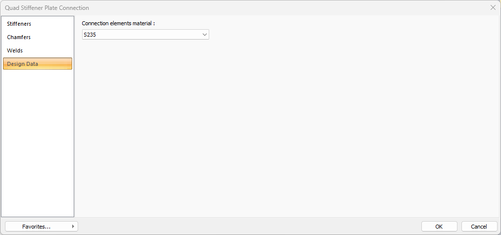

Design Data Tab
