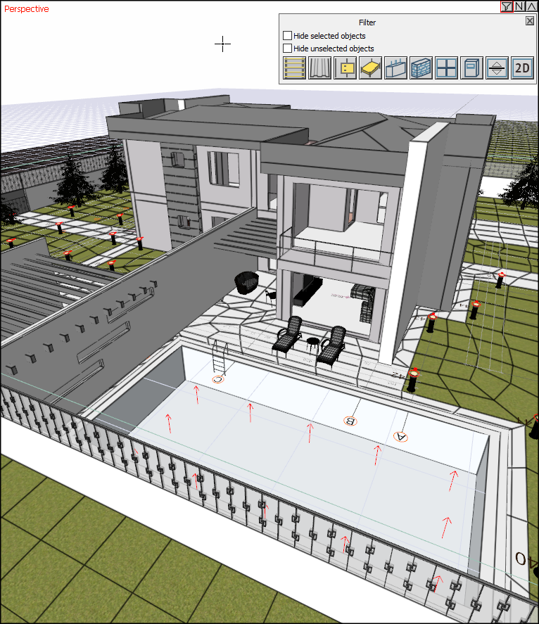

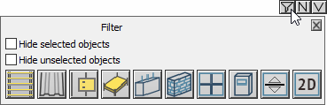

Object Filters
The filter icon in the upper right corner of the 3D perspective window is used to close and open objects. When the icon is clicked, the Filter dialog opens.
Hide selected objects
When checked, it closes all selected entities in 3D view.
Hide unselected objects
When checked, it closes all unselected entities in 3D view.
Hide purlins
When the icon is clicked, it closes or shows the purlins.
Hide sheetings/roofs
When the icon is clicked, it closes or shows the sheetings and roofs.
Hide connections
When the icon is clicked, it closes or displays connections.
Hide slabs
When the icon is clicked, it closes or shows the slabs.
Hide the shearwalls
Clicking the icon closes or shows the shearwalls.
Hide the walls
When the icon is clicked, it closes or shows the walls.
Hide curtain walls/exterior veneers
When the icon is clicked, it closes or shows the curtain walls and exterior veneers
Hide library elements
When the icon is clicked, it closes or shows the library elements.
Hide 2D objects
When the icon is clicked, 2D closes or shows all objects.

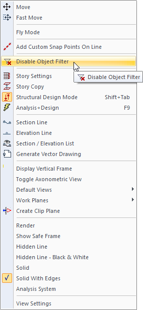

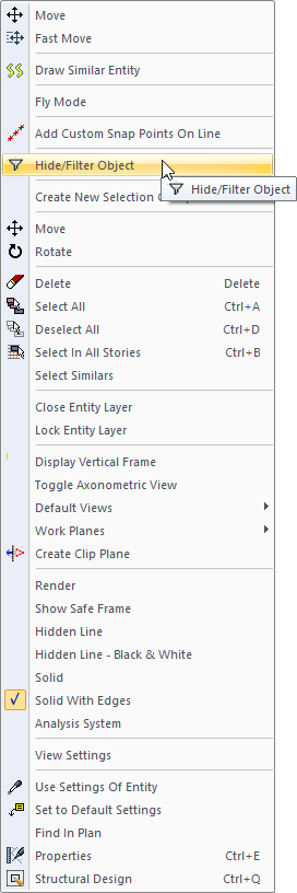

In addition, you can close the selected objects in 3D view with the Hide/Filter Objects command from the right-click menu on the perspective screen.
Then, you can make the hidden objects visible with the Cancel Object Filter command from the right-click menu.

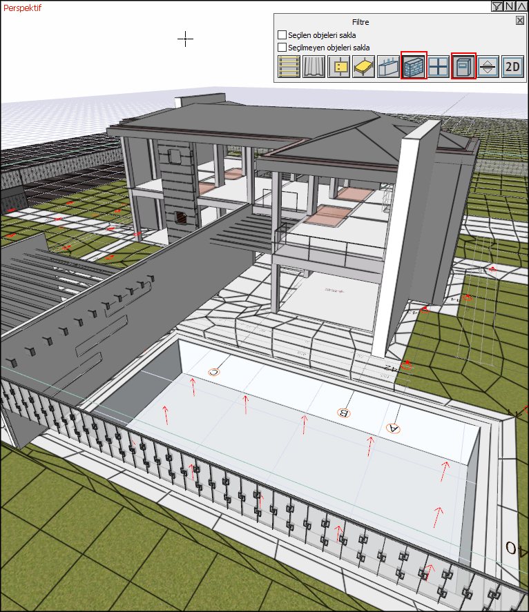

Sample for Filter

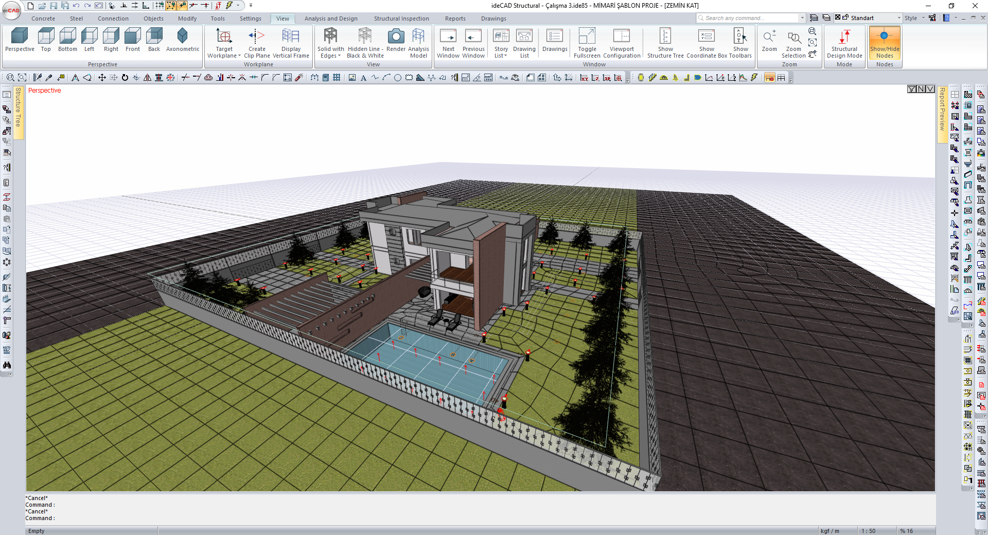

View without filter

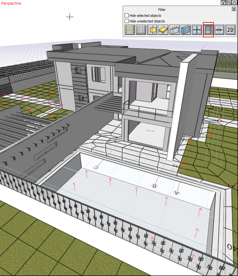

When libraries are closed
When walls and libraries closed

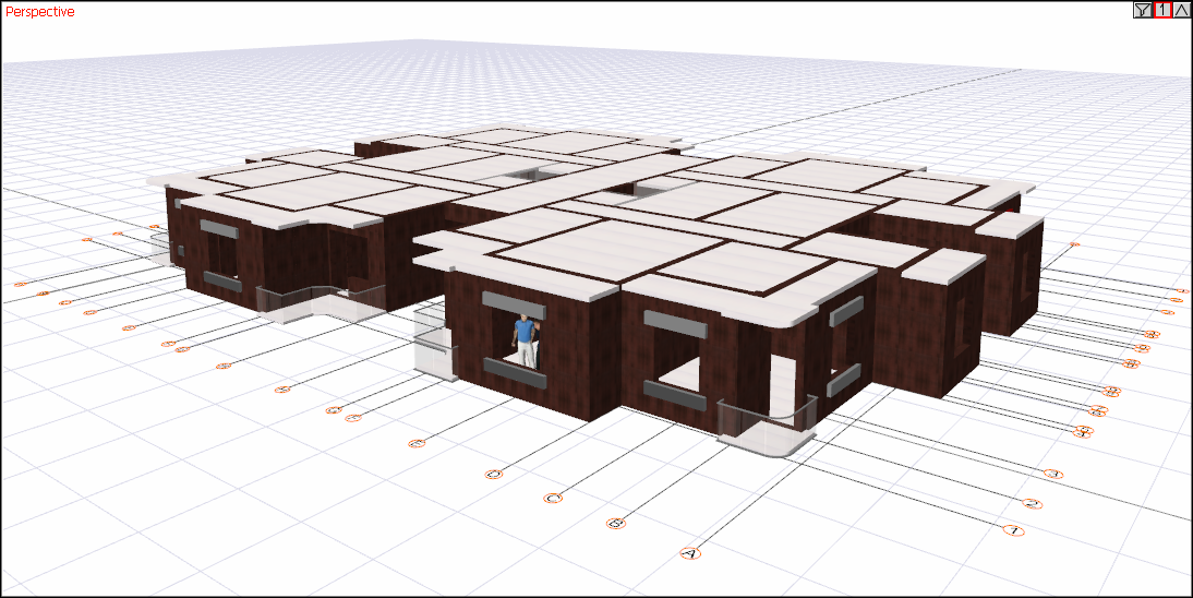

Active (working) Story or All Stories
Use the middle button of the icons in the upper right corner of the perspective view. When the button is pressed once, only the active floor is visible. Pressing again will reveal all layers
All stories
Active story

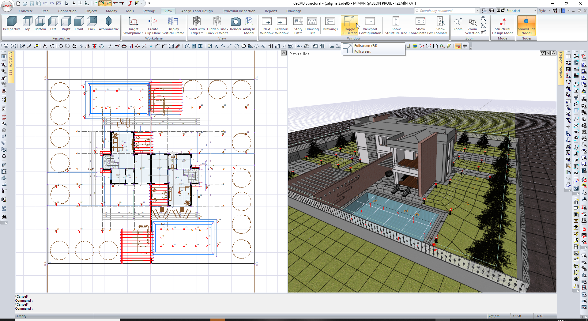

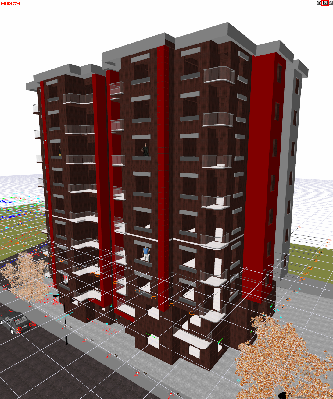

Full Screen Mode
With the full screen mode, you can see the 3D view completely. When clicked on full screen mode again, the view returns to its previous size. Also, the F8 key toggles fullscreen mode on and off.
With fullscreen mode off:
When full screen mode is on:
