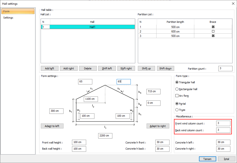

With the wind column count settings, the number of wind columns is changed for the front and back facade from the miscellaneous part of the hall settings dialog. The height of the wind columns will be determined automatically according to the form settings.

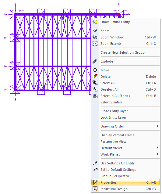

Select the hall where you want to change the count of wind columns and click the right mouse button. Click the Properties line from the right click menu that opens.
  • Enter the hall settings.

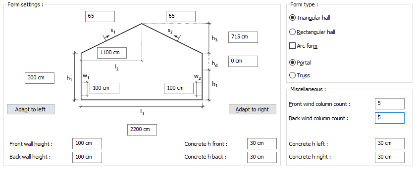

  • Enter the front and back wind column numbers.
  • You will have as many wind columns as the numbers you entered.

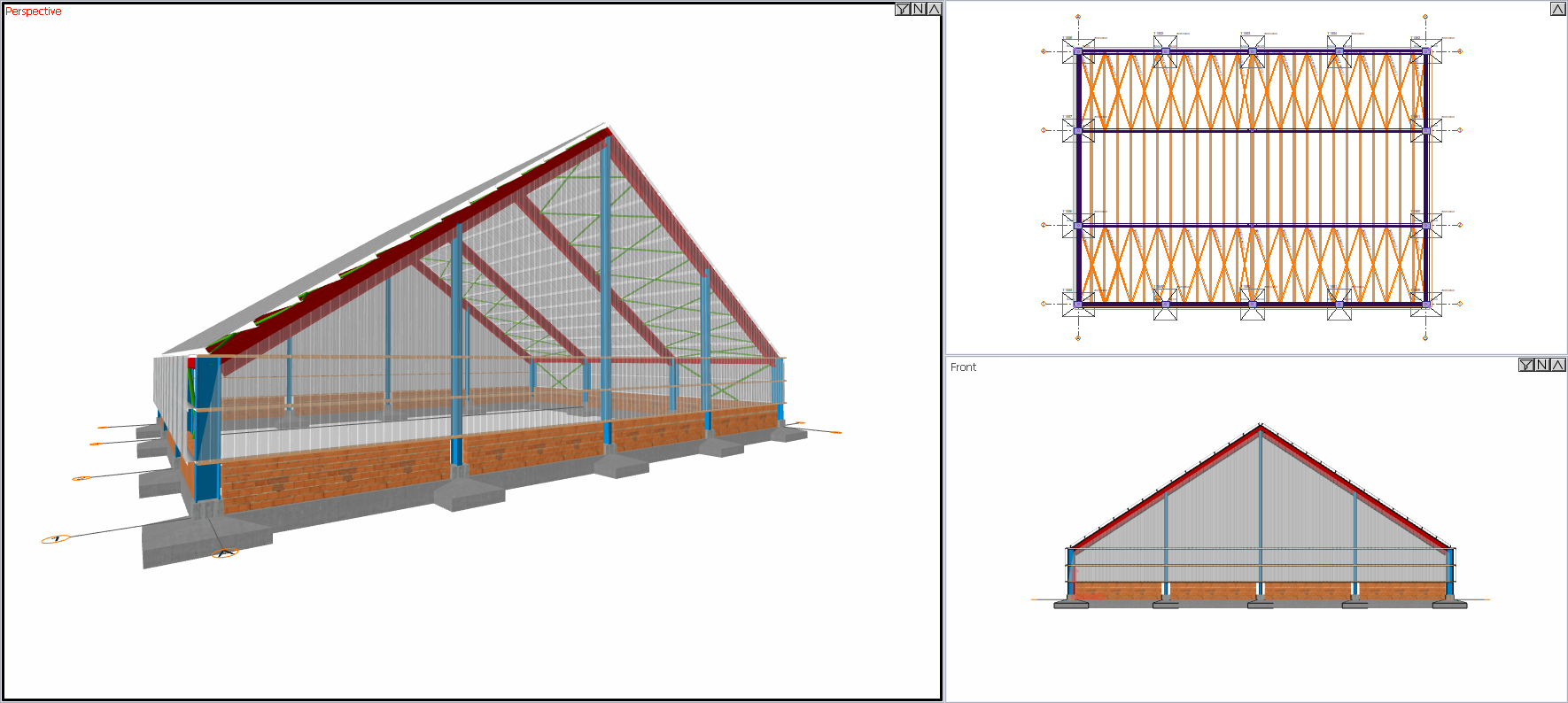

Hall view when the count of wind columns is 3
Settings

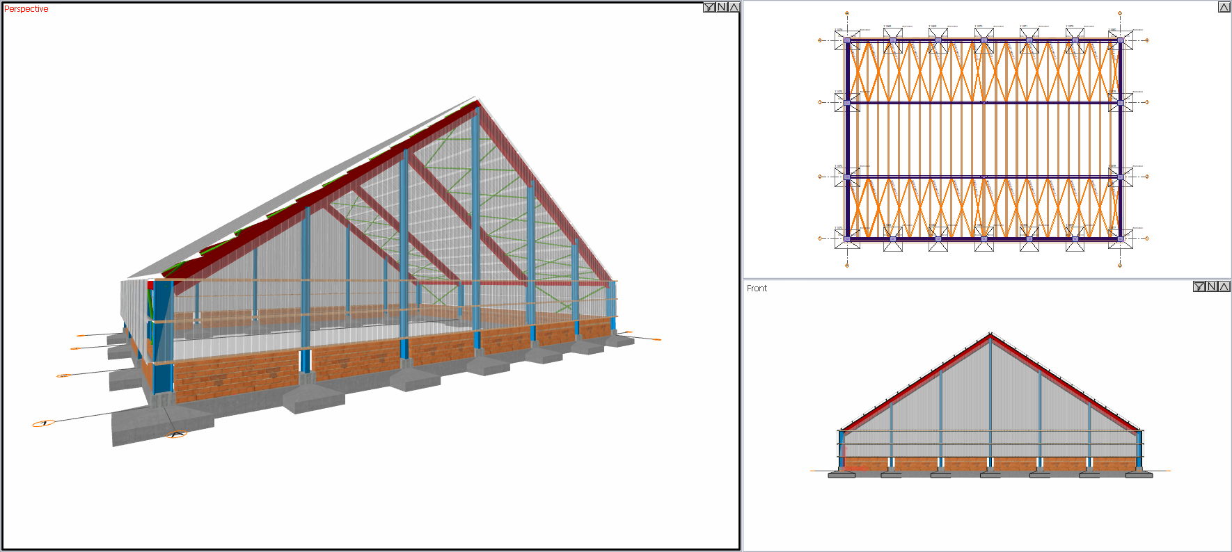

Hall view when the count of wind columns is 5
Settings
