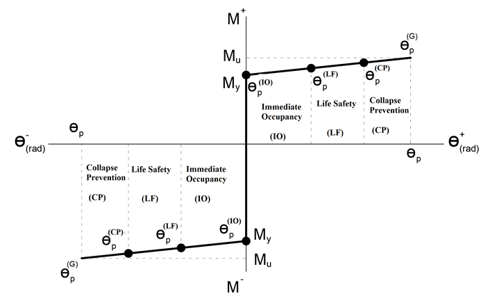

  • Plastic rotation limit value for controlled damage (KH) performance levels is calculated automatically according to Equation 5.7 and Equation 5.8 .
ICONS
θ p (LF) = Allowable plastic rotation limit for Controlled Damage performance level [rad]
θ p (CP) = Allowable plastic rotation limit for Preventing Damage performance level[rad]

TBDY Section 5.8.1.3 as' mentioned, stacked plastic behavior model of the plastic hinges calculated controlled damage (LF) Performance Level plastic rotation limit values for θ p (LF) , Eq. (5.7b) is calculated by.
Plastic rotation limit value θ p (CP) value for the Prevention of Collapse (CP ) Performance Level of plastic hinges for new buildings According to TBDY Section 5.8.1.2It is explained in detail in the Collapse Prevention Performance Level for Concentrated Plasticity Model. For the Controlled Damage (LF) Performance Level ofplastic hinges, the plastic rotation limit value θp(LF )taken into account as 0.75 times the θp(CP)
