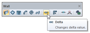

You can access it from the wall toolbar.

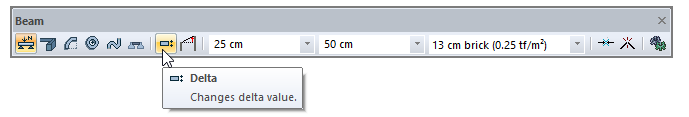

You can access it from the beam toolbar.

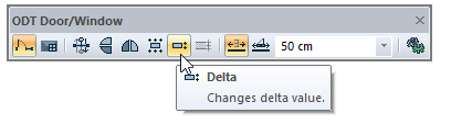

You can always access it from the ODT door/window toolbar.

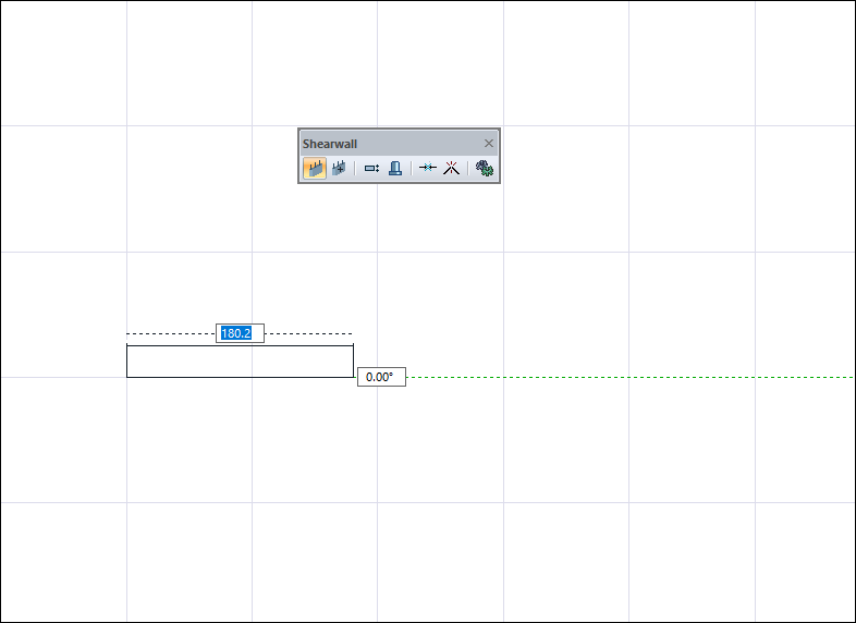

Before changing the shearwall delta

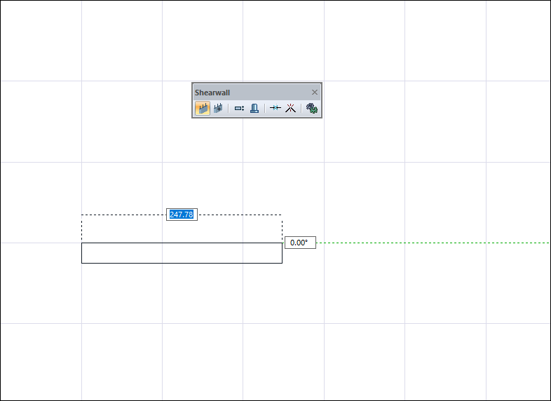

Changing holding point by clicking the delta button or pressing the spacebar
