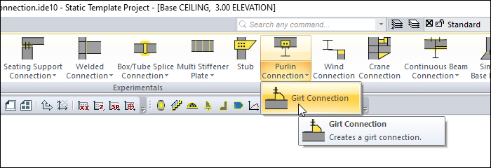

Location of the Girt Connection Command
  • Click the Girt Connection icon from the Connection menu.
  • From the 3D perspective view, click the beam or shears, then the purlin parts, respectively.
  •  The connection will occur with default settings.

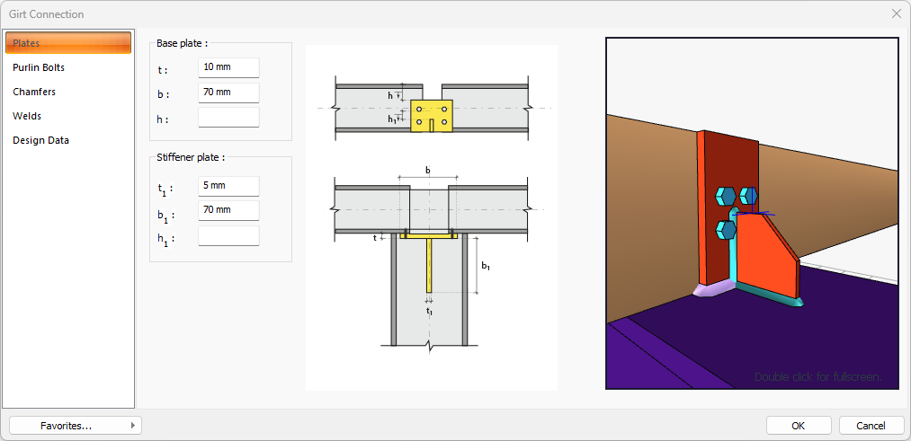

Sheets Tab
Base plate
It provides hinged or fixed connection depending on the placement of the connection anchors that allow the connection of steel columns to the foundation or reinforced concrete column.
Stiffener plate
The stiffener plate is determined by entering the value. The values ​​to be entered are shown in the schematic drawing.

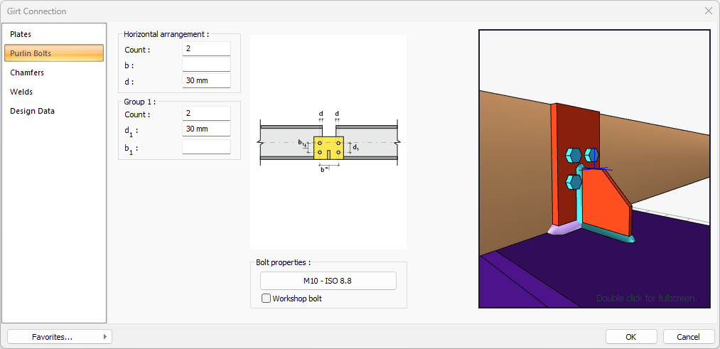

Purlin Bolts Tab
Horizontal arrangement
Group 1
Bolt properties

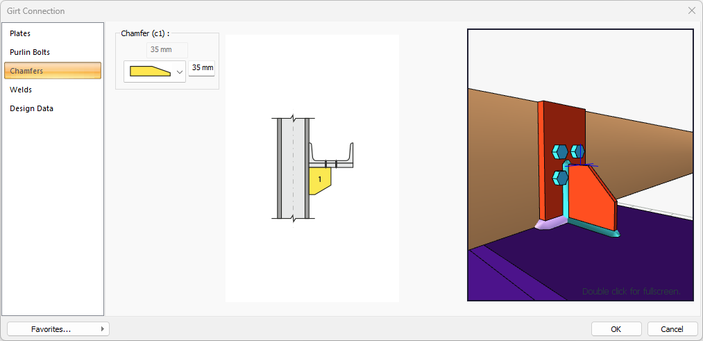

Chamfers Tab
Chamfer (c1)

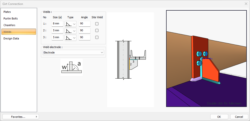

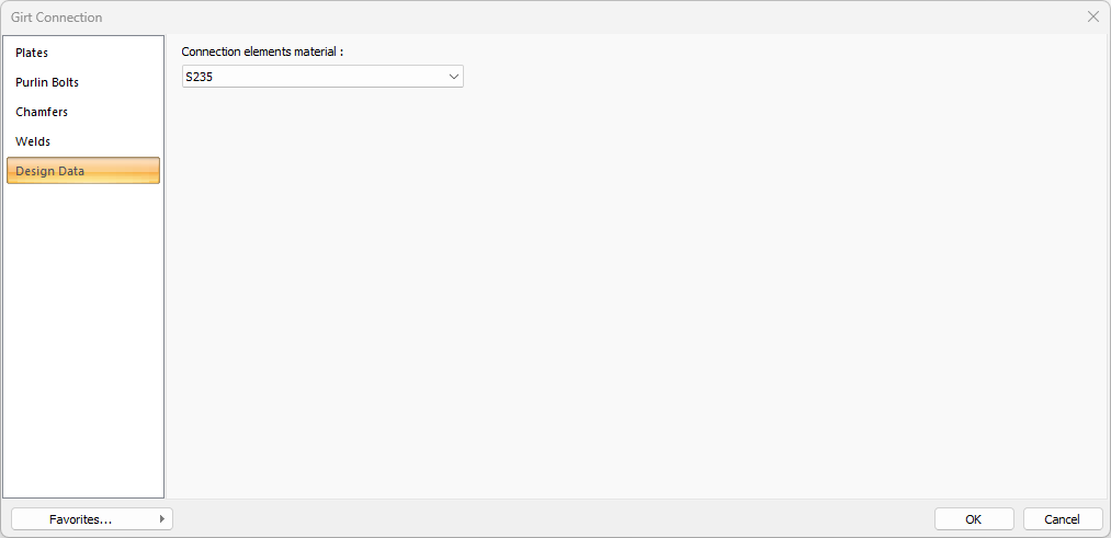

Welds Tab
Welds
Weld electrode
Design Data Tab
