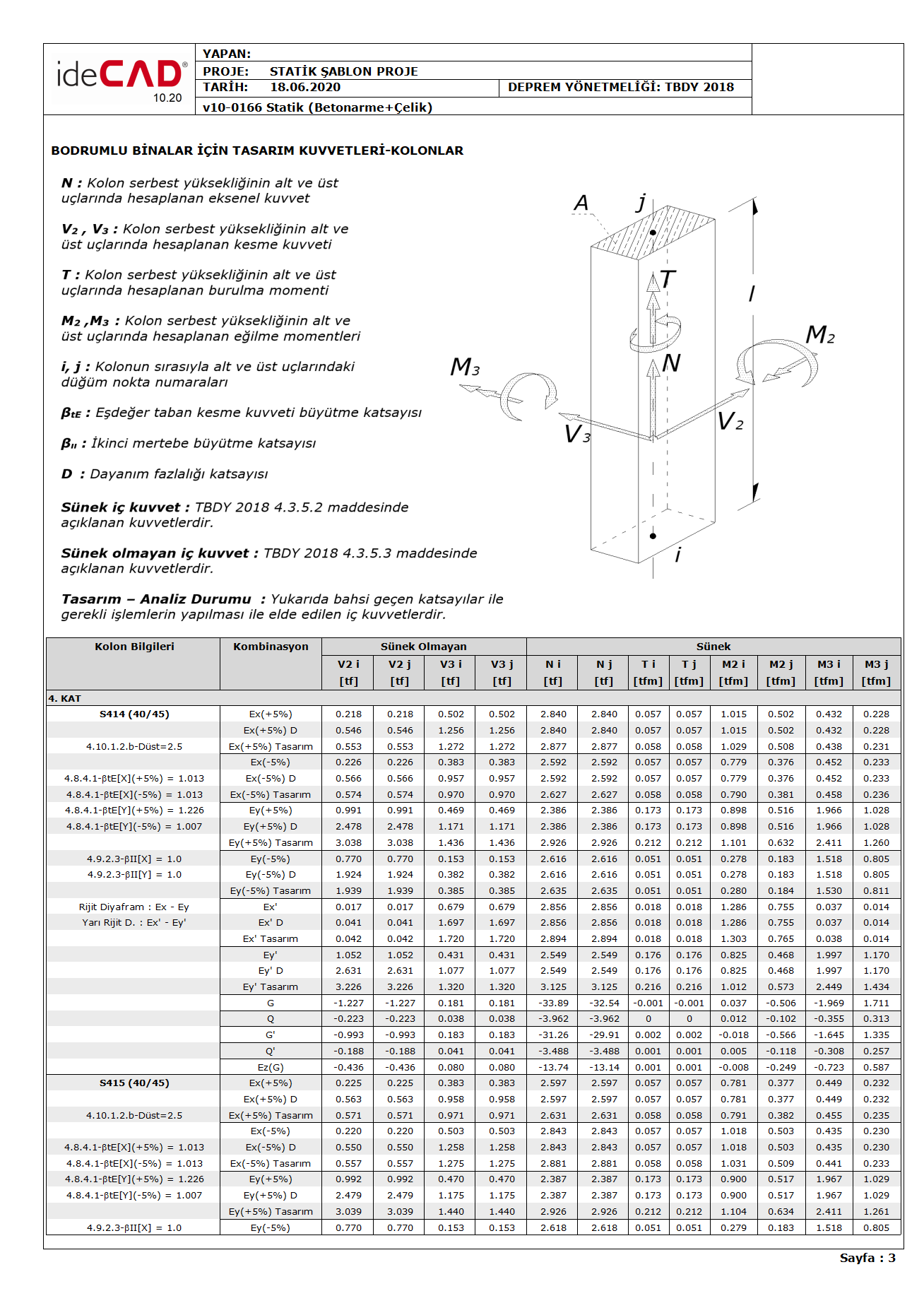

The cases where Strength Excess Coefficient D is applied can be seen in the design strength report of all elements. In the sample column report below, it is clearly seen at what forces the Strength Excess Coefficient D is applied.
