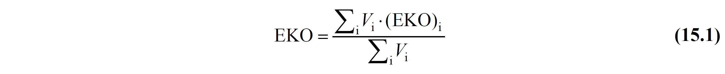

15.5.3.2 - ECO values ​​scaled with the shear force specified in items (c) and (d) above shall be calculated with Equation (15.1) .
In Equation (15.1) , i indicates the column number on the relevant floor, V i shows the shear force calculated in the i column, and (EKO) i indicates the ECO value calculated in this column according to 15.5.2.3 .
