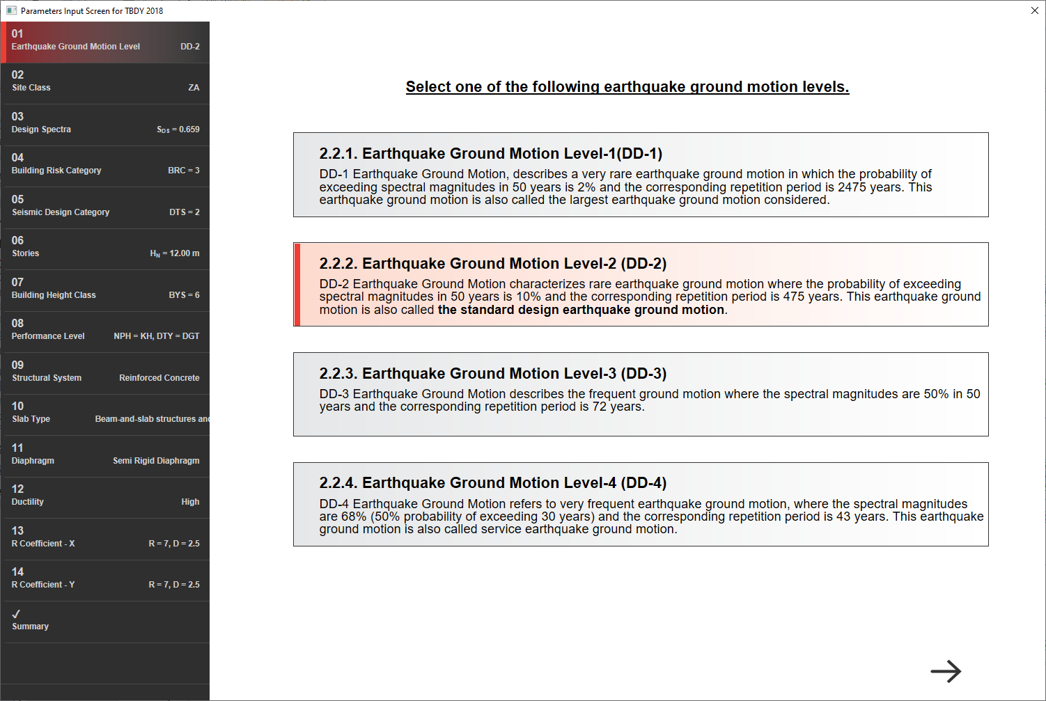

With the analysis settings wizard developed by ideCAD, the earthquake code parameters required for analysis and design are displayed sequentially. On the wizard screen, the earthquake ground motion level, site class, design spectra, building risk category, seismic design category, stories, building height class, performance level, structural system, slab type, diaphragm, ducility and R coefficient values ​​to be used for x and y directions are displayed in order, definable.

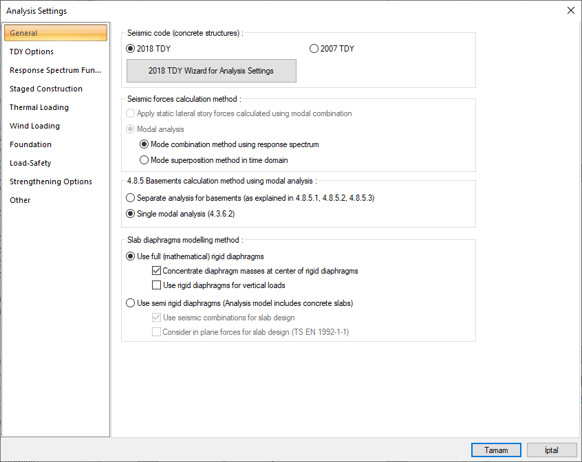

2018 TDY Wizard for Analysis Settings can be run from Analysis settings.
The wizard is run by clicking the TBDY 2018 Analysis Settings Wizard icon.
Clicking the Forward Arrow button at the bottom of the wizard screen will switch to the next step. Clicking the Back Arrow button will move to the previous step.
Earthquake Code Wizard Steps
