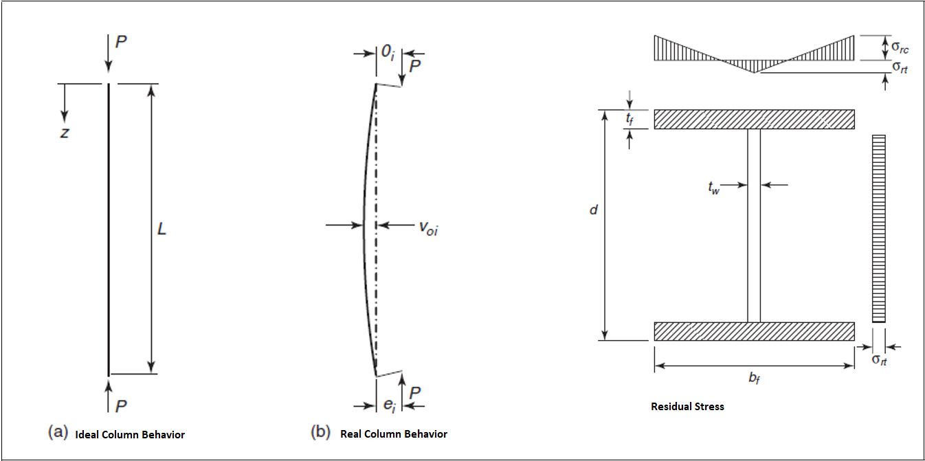

  • Elements under the effect of compression may not function as an ideal compression element due to various reasons, although the flexure moment does not occur as a result of loads. The most important reasons are:
- Initial Curvature
- Load eccentricity
- Residual Stresses

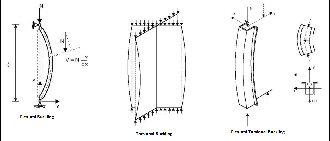

  • Global buckling is divided into 3 categories: Flexural buckling, Torsional buckling and Flexural-Torsional buckling.
