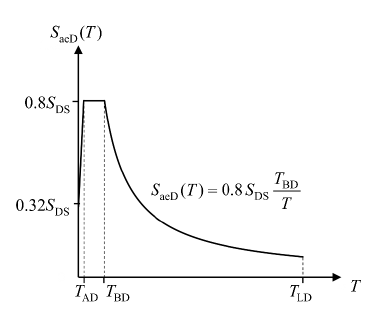

By using the coefficients obtained from the map by the program, the spectrum curve given in Figure 2.3 with Equation 2.5 - 2.6 is automatically made.

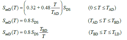

F S = Local ground impact coefficient for the short-period region
F 1 = Local ground impact coefficient for a period of 1.0 seconds
S DS = Short-period design spectral acceleration coefficient [dimensionless]
S D1 = Design spectral acceleration coefficient for a period of 1.0 seconds [dimensionless]
S S = Short period map spectral acceleration coefficient [dimensionless]
S 1 = map spectral acceleration coefficient for a period of 1.0 seconds [dimensionless]
S aeD (T) = Vertical elastic design spectral acceleration [g]
T AD = Vertical elastic design acceleration spectrum corner period [s]
T BD = Vertical elastic design acceleration spectrum corner period [s]
T LD = Transition period to constant displacement region in vertical elastic design spectrum [s]

With the spectral acceleration coefficients obtained from AFAD depending on the coordinates, the vertical elastic design spectrum S aeD (T) is calculated according to the formula below . For the vertical elastic design spectrum, it is represented by a total of 3 functions, different in each region, and shown in the graph below.
T AD and T BD vertical spectrum vertex periods and T LD period are given below .
