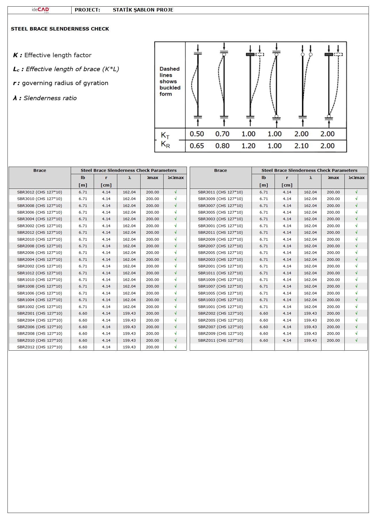

Slenderness Ratio Report for SCBF design per AISC 341-16 with ideCAD
How does ideCAD control the slenderness ratio according to AISC 341-16?
  • ideCAD Structural controls and reports brace slenderness ratio automatically.
The slenderness ratio is checked and reported automatically by the ideCAD Structural. Braces must have a slenderness ratio of KL / r ≤ 200.
