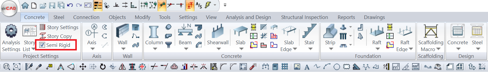

Location of Semi-Rigid Command
By activating the Semi-Rigid option under the Analysis Model heading in the Analysis and Design menu in the Ribbon Menu, you can solve the slabs with the assumption of a semi-rigid diaphragm.
The Semi-Rigid diaphragm solution can also be selected from the Analysis Settings window.
