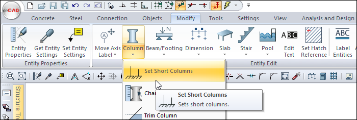

Location of Set Short Columns Command
You can access it from the ribbon menu Modify tab under the Entity Edit heading.
  • Select the column or columns you want to set as short columns.
  • Click on the set short columns icon.

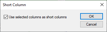

  • In the short column dialog that opens, "Use selected columns as short columns." check the option.
  • The criteria specified in TBDY 2018 Article 7.3.8 will be applied to the column or columns you have chosen.
