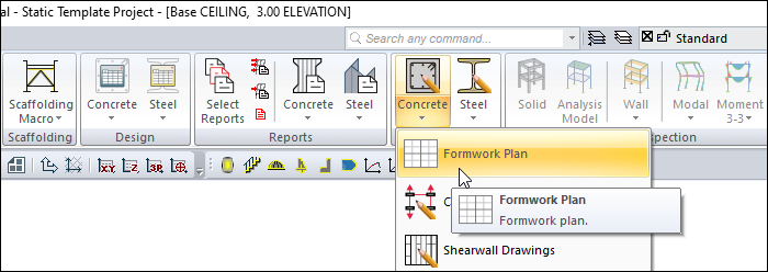

Location of the Formwork Plan Command
You can access it under the ribbon menu Concrete tab, Create Drawing heading.
  • Click on the formwork plan icon.
  • Edit your settings in the drawing properties dialog that opens.
  • When you click the OK button, your formwork plan will be created.

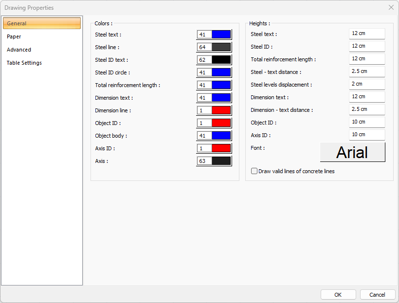

General Tab
Specifications - Colors
Steel text
Steel line
Steel ID text
Steel ID circle
Total reinforcement length
Dimension text
Dimension line
Object ID
Object body
Axis ID
Axis
Adjusts the color of the axis. When the color box is clicked, the appropriate color is selected from the window that opens.
Specifications - Heights
Steel text
Steel ID
Steel - text distance
Steel levels displacement
Dimension text
Dimension - text distance
Object ID
Axis ID
Font
Draw valid lines of concrete lines
When marked, distance lines become visible.

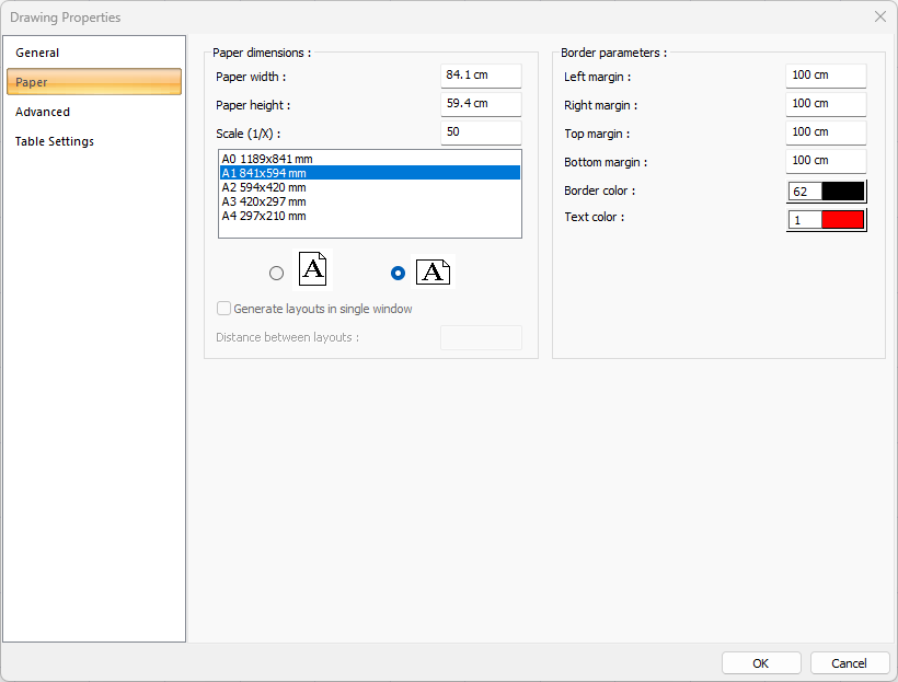

Paper Tab
Paper width
Paper height
Scale (1/X)
Standard paper sizes
Vertical/Horizontal use
Distance between layouts
Left margin
Right margin
Top margin
Bottom margin
Border color
Text color

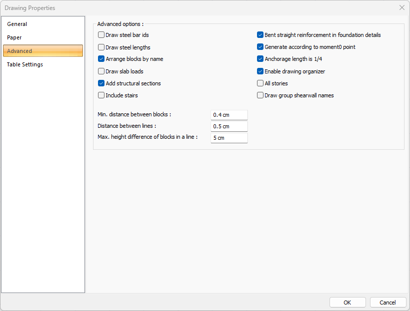

Advanced Tab
Draw steel bar ids
Draw steel lengths
Arrange blocks by name
Draw slab loads
Add structural section
When the option is selected, structural sections will be created automatically in the formwork plan.
Include stairs
When the option is selected, if there is a stair defined in the story ceiling plan, it will be drawn in the formwork plan.
Anchorage length is 1/4
Enable drawing organizer
All stories
Draw group shearwall names
If checked, shearwall group names are written in the formwork plan drawings.
Min. distance between blocks
Distance between lines

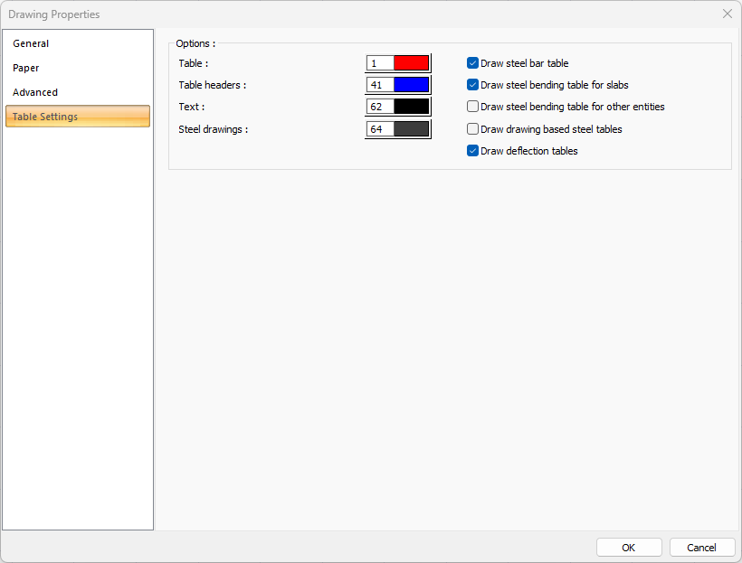

Table Settings
Table
Table header
Text
Steel drawings
Draw steel bar table
Draw deflection tables
While preparing the formwork plan, it displays the total deflection values ​​of the beams and slabs and the deflection table is added to the formwork plan drawing according to the selection made from the table.
