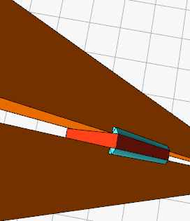

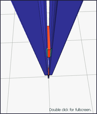

With the Spacer Plate command, the plates that connect the combined angle brackets are defined. When double angle brackets are used on braces, the spacers are placed automatically. When the spacer plates are double clicked, the connection properties are opened.

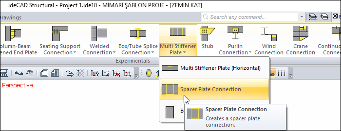

Location of the Spacer Plate Connection Command
  • Click on the Spacer Plate Connection icon from the Connection menu.
  • The spacer plate connection settings dialog will open.
Location of the Spacer Plate Connection Settings Dialog

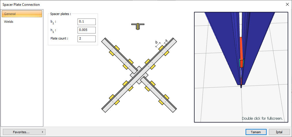

Spacer plates

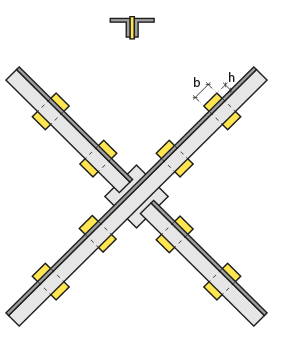

The number of spacer plates and their properties are determined by entering values. The values ​​to be entered are shown in the schematic drawing.

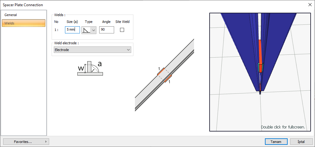

Welds Tab
Welds
Weld electrode
