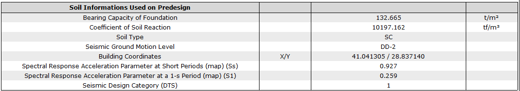

  • According to the geotechnical report created for the building, soil parameters are as follows:
Local Soil Type
ZC
Coefficient of subgrade reaction
100000 kN/m 3
Bearing capacity of foundation
1301 kN/m 2
Soil Unit Weight
18 kN/m 3

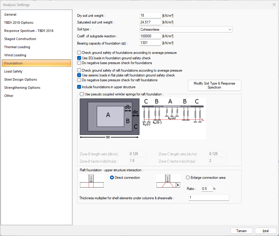

Analysis Settings and Geotechnical Report
  • Soil parameters are arranged in Analysis Settings, Foundation tab. Parameters should be checked from analysis settings and geotechnical report.
