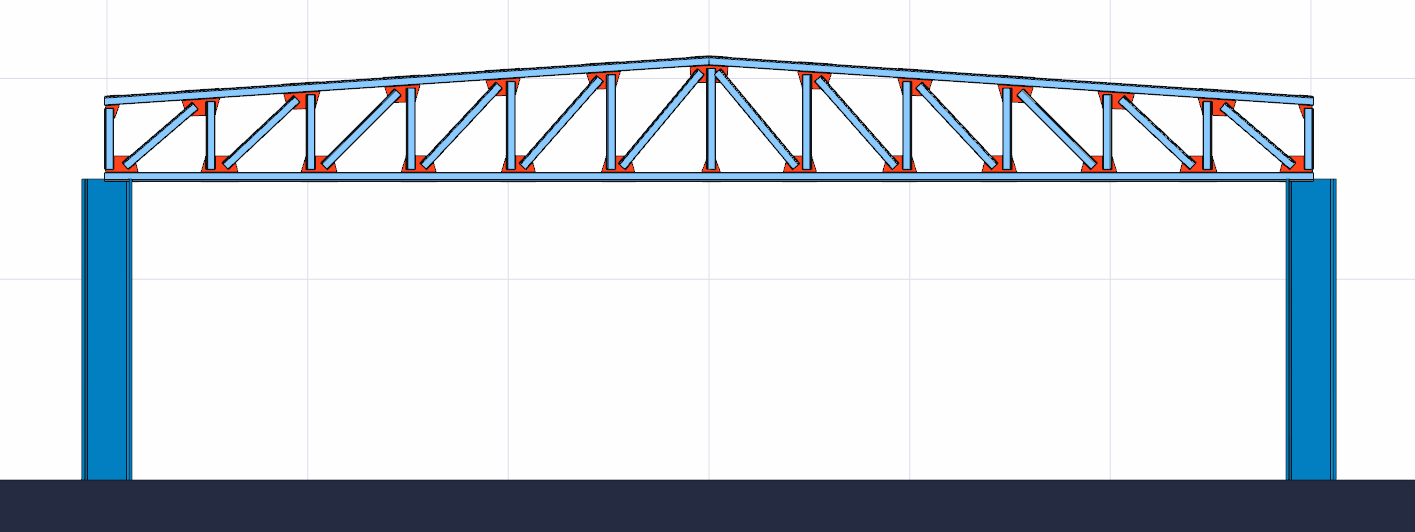

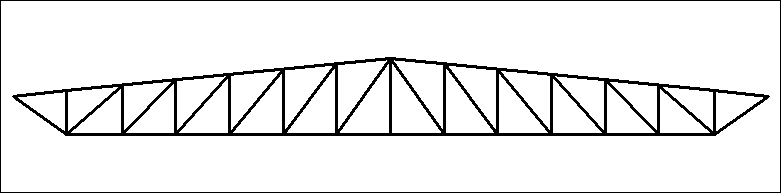

With the Trapezoid Type 1 command, the trapezoid truss type which is one of the prepared truss types, is drawn quickly. Truss heights are adjusted from the truss settings.

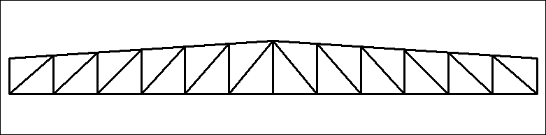

Trapezoid Type 1 Truss Schematic Drawing:

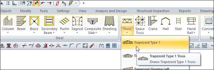

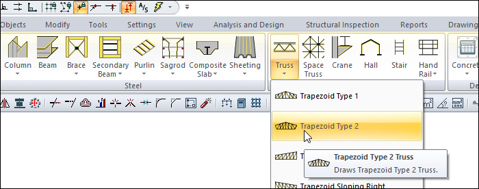

Location of the Trapezoid Type 1 Command
  • Click on the trapezoid type 1 command.

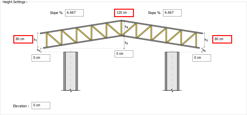

  • In the Heights tab , enter the heights h1 , h2 and h4 for trapezoid type 1.

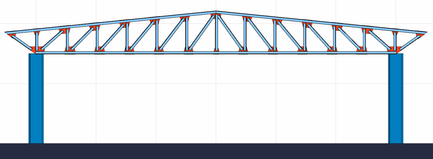

Entering 80 cm for h1 and h2 and 120 cm for h4 in the height tab of the truss settings
