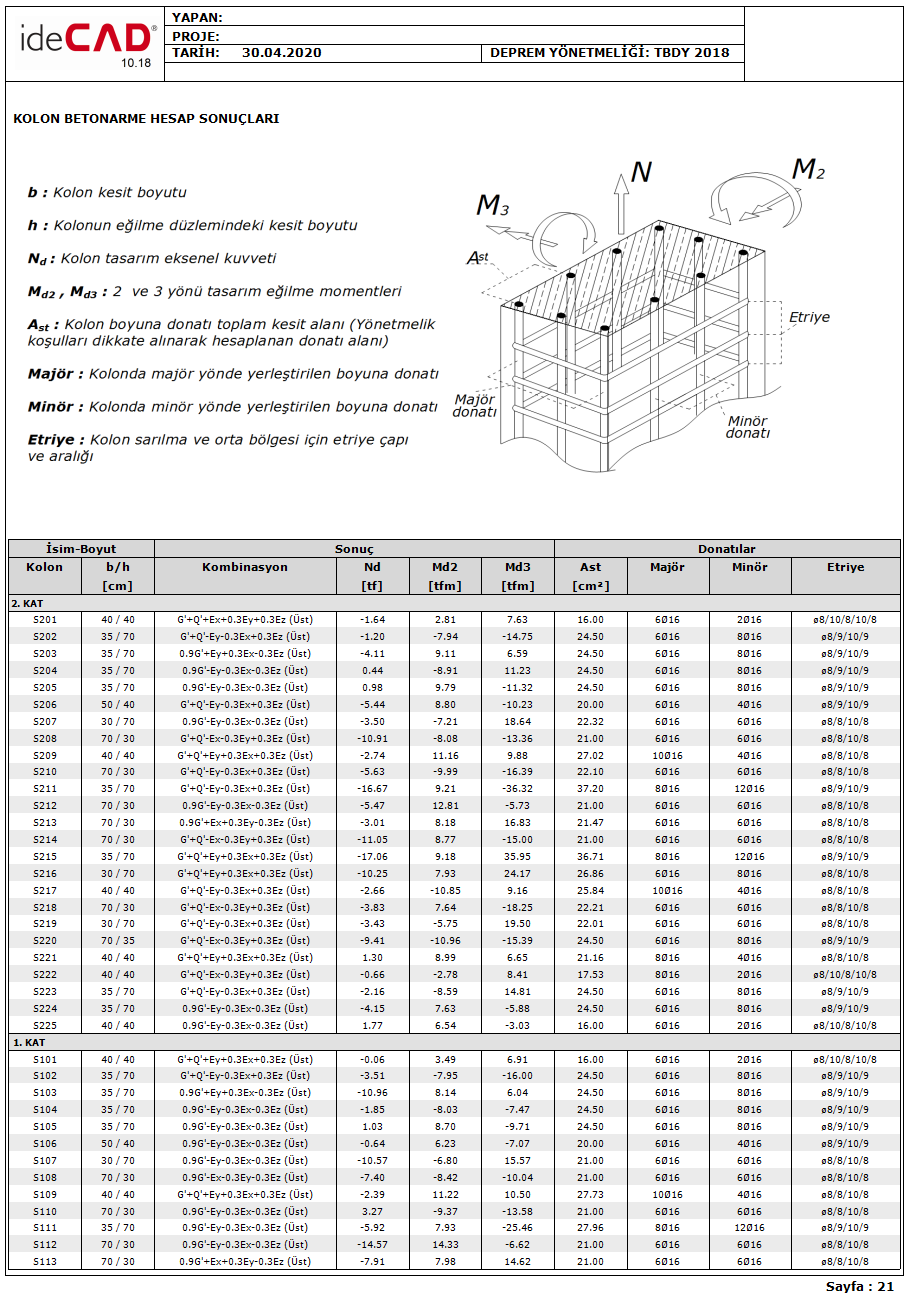

Column Longitudinal Reinforcement Reports
ICONS
Column = Floor and name where the column is located
b / h = Column cross-section dimensions
Combination = The combination that is taken as basis in the column reinforced concrete calculation. For parenthesis, top and bottom are written and the information on which node it occurs is also written.
Nd = Axial force taken as basis in column reinforced concrete calculation
Md2 = 2 axis moment taken as basis in column reinforced concrete calculation
Md3 = 3 axis moment taken as basis in column reinforced concrete calculation
Ast = It is the one greater than the reinforcement area calculated from the column reinforced concrete calculation and the reinforcement area calculated according to the specification.
Major =Total number and diameter of reinforcement placed in the direction of 2 axes of the column
Minor = Total number and diameter of reinforcement placed in the direction of 3 axes of the column
Stirrup = Diameter of the transverse reinforcement and the middle zone, confinement, junction and joint area transverse reinforcement intervals respectively
The longitudinal reinforcements of the columns are given under the heading of Column Reinforced Concrete Calculation Results in the Column report.
The reinforced concrete calculation of rectangular columns is made according to the section under the effect of biaxial bending and axial load by using the bearing strength method.
