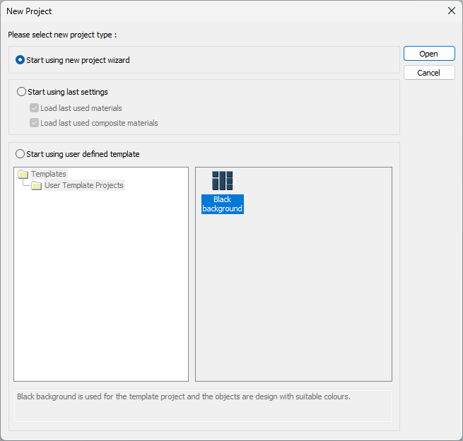

Location of the New Project Wizard
You can access it from the new project dialog that opens when you click on the new project command.

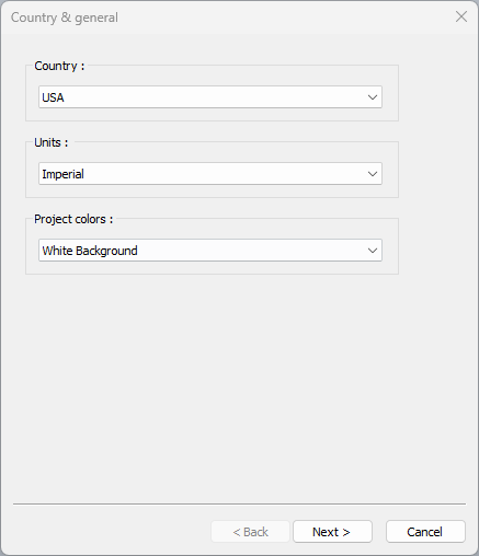

Country & General Dialog
Country
Country selection is made from the list. International, USA, Türkiye, Indonesia, Dominican Republic, Thailand, Philippines and Pakistan are the countries on the list.
Units
 The unit according to the selected country is automatically selected. If desired, it can be changed by selecting one of the imperial, metric (kN) and metric (tf) options from the list.
Project colors
 One of the background colors white, black, gradient grey, gradient blue and gradient black is selected.

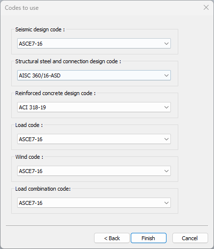

Codes to Use Dialog
Seismic design code
 According to the selected country, the seismic design code is selected. IBC, UBC 97 for International; ASCE7-16, UBC 97, IBC for USA; TBDY 2018, TDY 2007 for Türkiye; SNI 1726 for Indonesia; MOPC R-001 for the Dominican Republic; DPT 1302-61 2019 for Thailand; NSCP 2015 for the Philippines; BCP SP 2007 seismic design codes for Pakistan are listed.
Structural steel and connection design code
According to the selected country, the structural steel and connection design code is selected. AISC 360/16-ASD, 360/16-LRFD for International; AISC 360/16-ASD, 360/16-LRFD for USA; TÇY 2018-GKT, TÇY 2018-YDKT, AISC 360/16-ASD, 360/16-LRFD, TS-EN-1993-1-1 for Türkiye; SNI 1729-2015-DKI, SNI 1729-2015-DDBK for Indonesia; AISC 360/16-ASD, 360/16-LRFD for the Dominican Republic; AISC 360/16-ASD for Thailand; AISC 360/16-ASD, 360/16-LRFD for the Philippines; AISC 360/16-ASD, 360/16-LRFD structural steel and connection design codes are listed for Pakistan.
Reinforced concrete design code
According to the selected country, the reinforced concrete design code is selected. ACI 318-19 for International; ACI 318-19 for USA; TS500 for Türkiye; SNI 0328-47 2013 for Indonesia; ACI 318-19 for the Dominican Republic; ACI 318-19 for Thailand; ACI 318-19 for the Philippines; ACI 318-19 reinforced concrete design codes for Pakistan are listed.
Load code
According to the selected country, the load coda is selected. IBC for International; ASCE7-16, UBC 97, IBC for USA; TS 498 for Türkiye; ASCE7-16, UBC 97, IBC for Indonesia; ASCE7-16, UBC 97, IBC for the Dominican Republic; ASCE7-16, UBC 97, IBC for Thailand; ASCE7-16, UBC 97, IBC for the Philippines; ASCE7-16, UBC 97, IBC load codes for Pakistan are listed.
Wind code
According to the selected country, the wind code is selected. IBC for International; ASCE7-16, UBC 97, IBC for USA; TS-EN-1994-1-1, TS498 for Türkiye; ASCE7-16, UBC 97, IBC for Indonesia; ASCE7-16, UBC 97, IBC for the Dominican Republic; ASCE7-16, UBC 97, IBC for Thailand; ASCE7-16, UBC 97, IBC for the Philippines; ASCE7-16, UBC 97, IBC wind codes for Pakistan are listed.
Load combinations code
According to the selected country, the load combination code is selected. IBC for International; ASCE7-16, UBC 97, IBC for USA; TBDY 2018 for Türkiye; ASCE7-16, UBC 97, IBC for Indonesia; ASCE7-16, UBC 97, IBC for the Dominican Republic; ASCE7-16, UBC 97, IBC for Thailand; ASCE7-16, UBC 97, IBC for the Philippines; ASCE7-16, UBC 97, IBC load combination codes for Pakistan are listed.

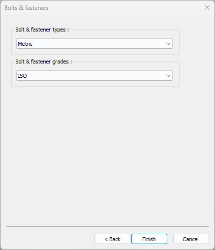

Bolts & Fasteners Dialog
Bolt & fastener types
One of the metric, imperial or metric+imperial bolt and fastener type is selected.
Bolt & fastener grades
One of the ISO, ASTM or ISO+ASTM bolt & fastener grade is selected.
