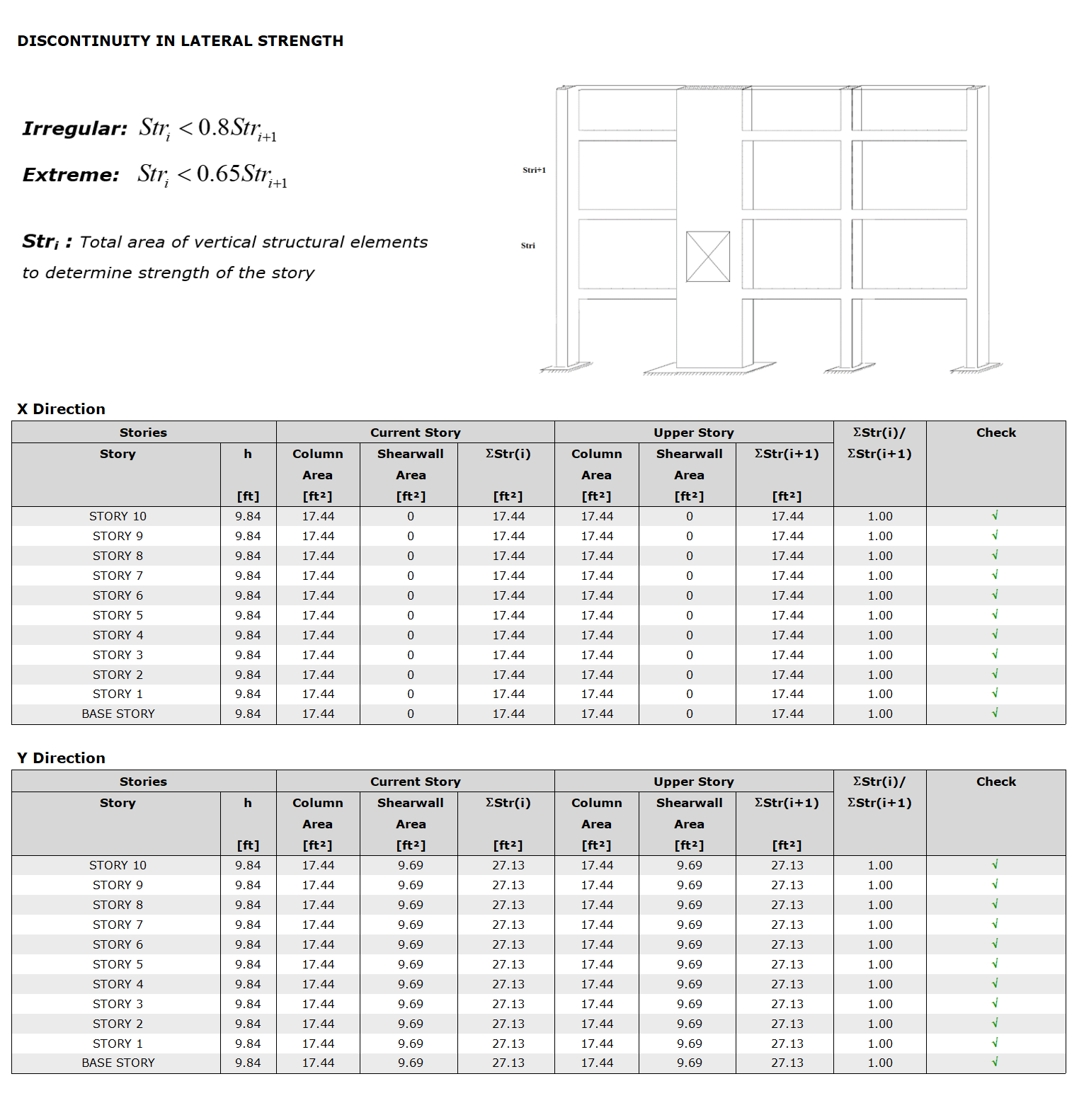

How does ideCAD control the weak story irregularity, according to ASCE 7-16, for two earthquake directions?
  • Weak Story Irregularities are checked in the Irregularity Report, and necessary conditions are applied.
SYMBOLS
Stri = Lateral strength defined at the i'th story
Discontinuity in lateral strength–weak story irregularity, is calculated as follows,
The Strength Irregularity Coefficient = ( Str )i / ( Str )i+1 < 0.80
Discontinuity in lateral strength–extreme weak story irregularity, is calculated as follows,
The Extreme Strength Irregularity Coefficient = ( Str )i / ( Str )i+1 < 0.65
