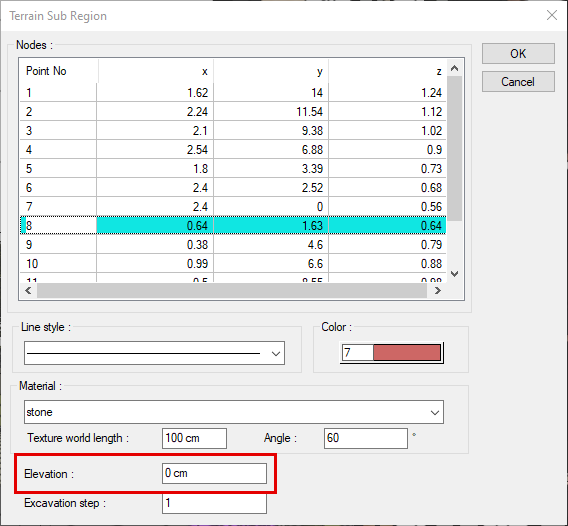

Location of the Elevation Feature
You can access the elevation feature from the terrain sub-region dialog whose elevation is desired to be changed.

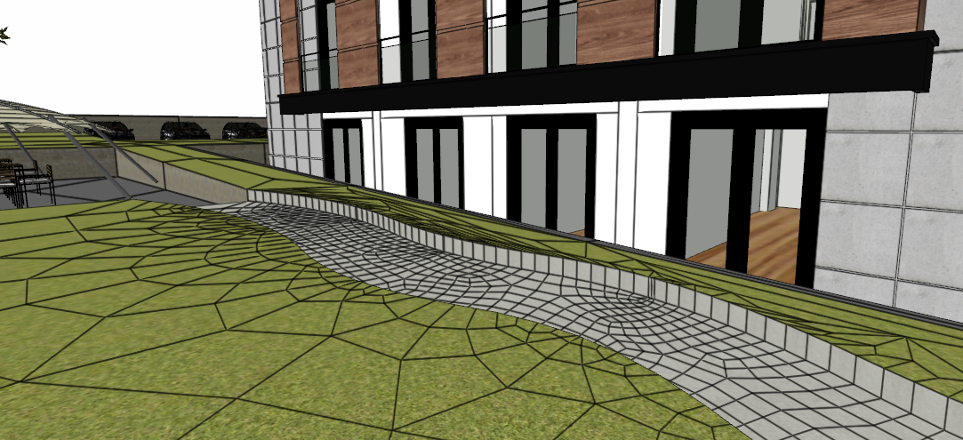

Terrain sub-region when the elevation value is 0

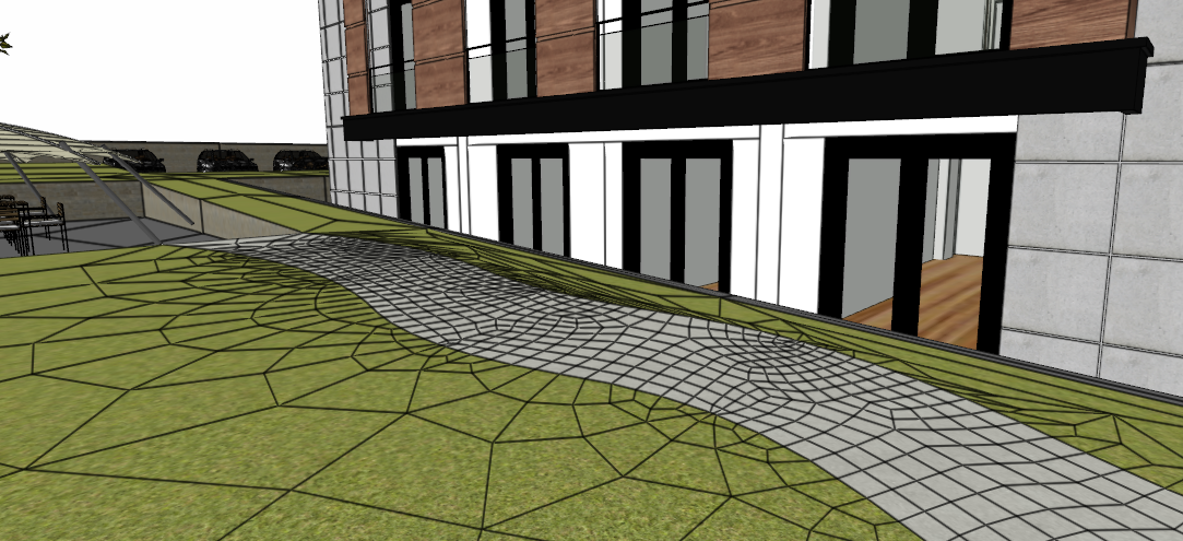

Terrain sub-region when the elevation value is -20
