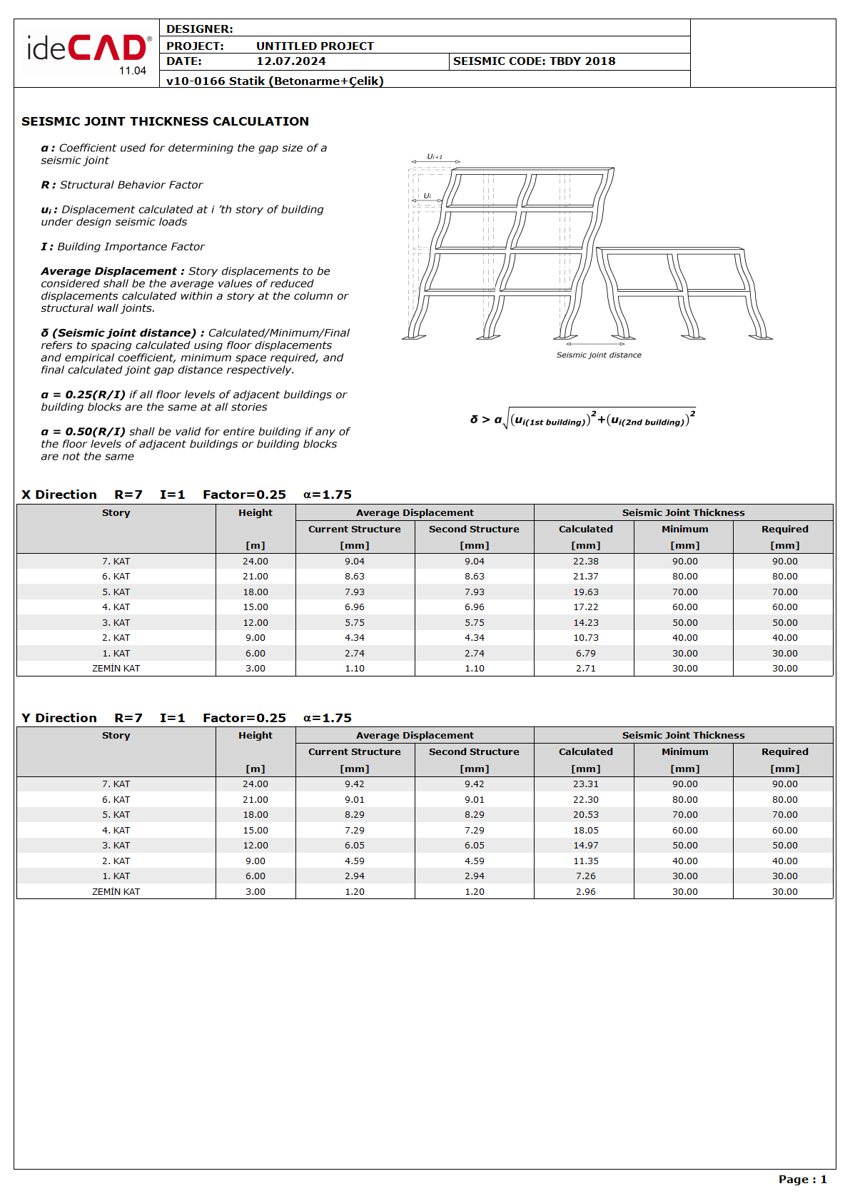

It provides parameters for Seismic joint calculation and the creation of earthquake joint reports for the Turkish Seismic Code.

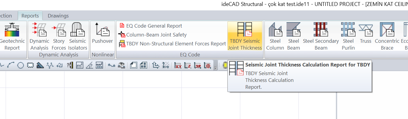

Location of Seismic Joint Thickness Report
You can access the Reports tab under the title of EQ Code.
Example of Seismic Joint Thickness Report pages
