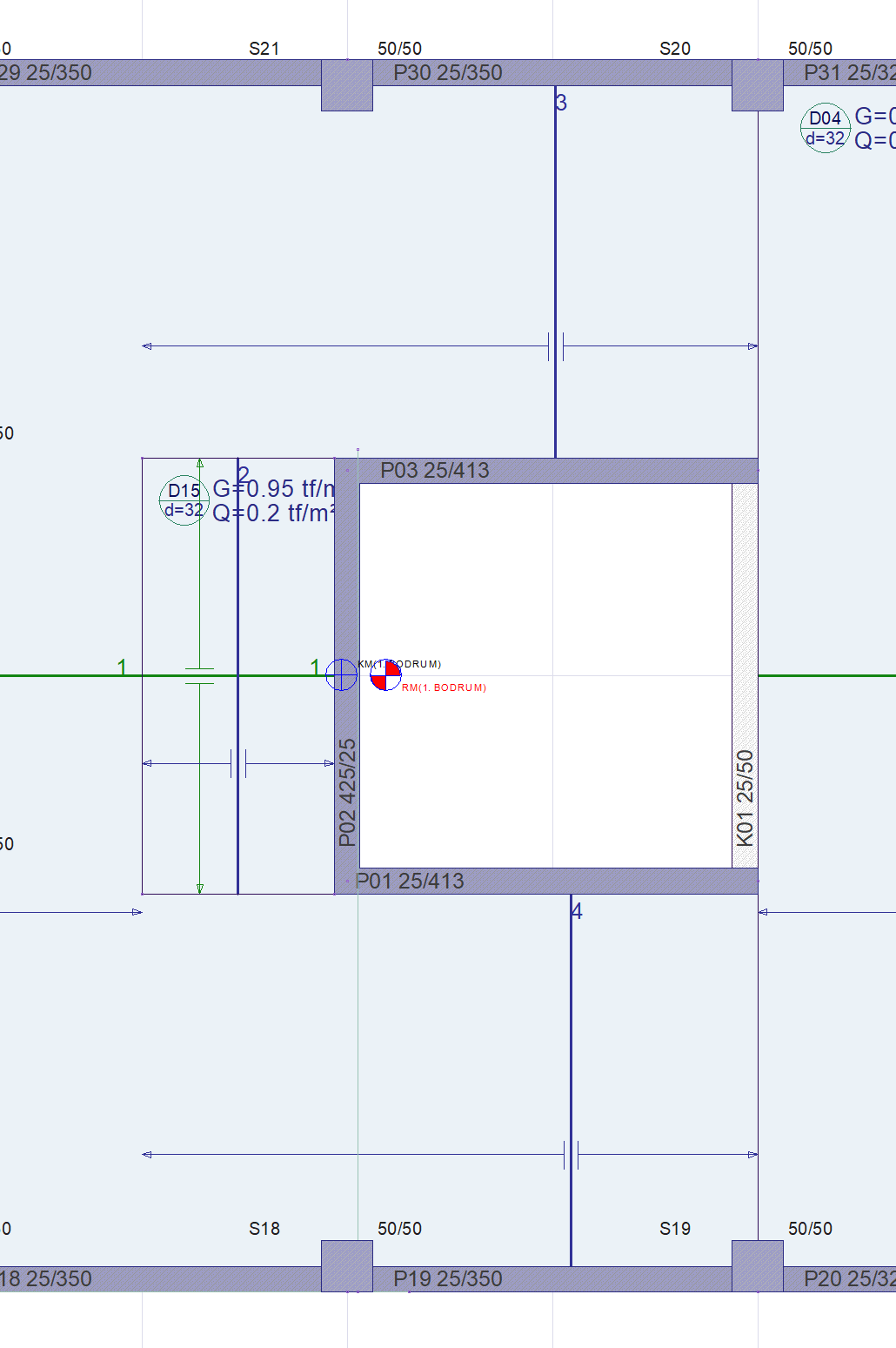

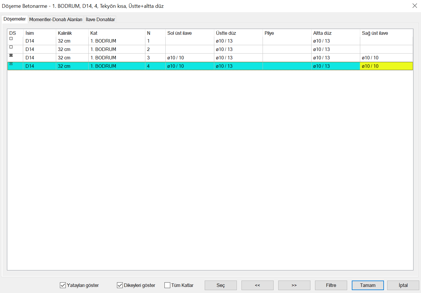

    • Additional reinforcement can be added to the support area of ​​the relevant slab,
    • flooring reinforcement type can be selected as top flat+bottom flat ,
    • In the region where the tensile stress is high, a new reinforcement calculation axis can be defined and the amount of reinforcement in this region can be increased,
    • In the region where the tensile stress is high, a new slab can be defined with the help of the slab edge command and the reinforcement of this slab can be increased.
    • slab thickness can be increased,
    • the diameter of the floor reinforcements can be increased and the spacing can be reduced.
