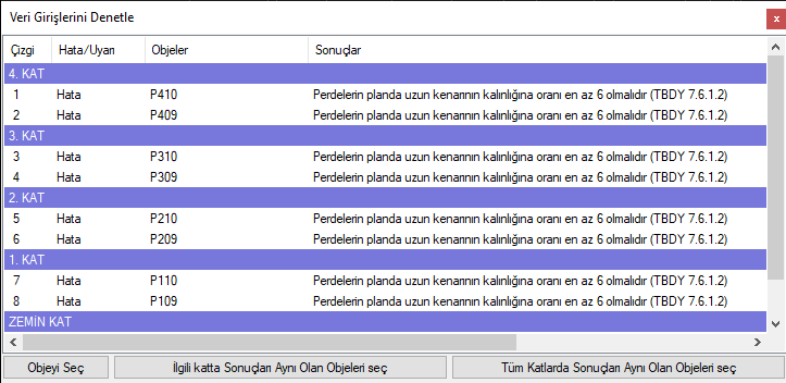

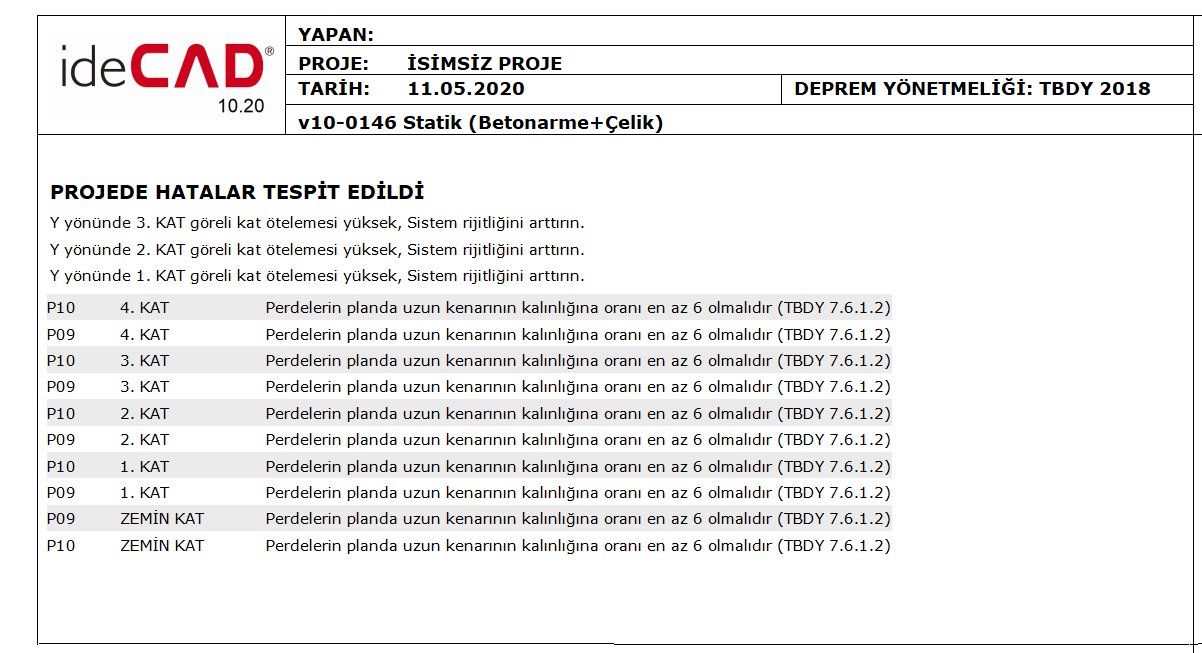

Rectangular reinforced concrete curtains are structural system elements defined as at least 6 (six) ratio of length to thickness in the section . In the geometry control and the optional report, the ratio of the length in the cross section to its thickness is automatically checked and a warning is given if there is any not suitable for control.
