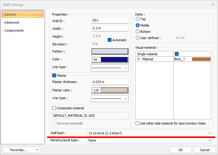

If a wall is drawn with the wall command on the beam and the wall load is entered in the beam settings, which one is taken into consider?
Beam wall load can be entered in the Beam Settings dialog Structural Concrete tab from the Wall load line or with the wall command. If there is a wall drawn on the beam with the wall command, the program takes into consider the load from the drawn wall. The wall load entered in the beam settings is not taken into consider. (In case of a wall object on the beam, the load value must be entered in the wall settings.)
