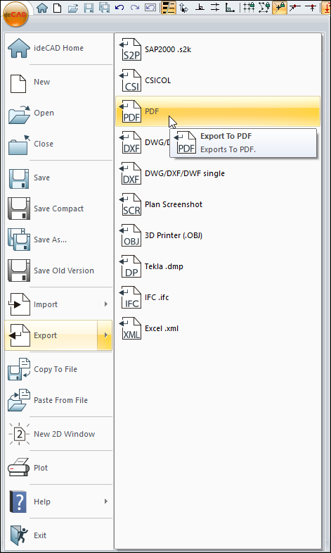

Location of the PDF Command
Transferring Project Drawings, Details, Expansions and 3D Project Data in Pdf Format
  • Clicking the ideCAD Logo in the upper left corner of the program, click the Export/Pdf command from the menu that opens.

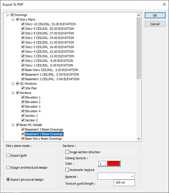

  • The Export to PDF dialog will open.
  • A file name is given in the dialog.
  • A dialog with options for PDF export will open.
  • After editing the options, click the OK button.

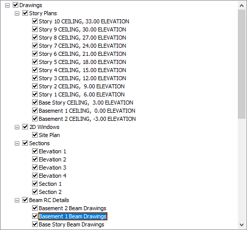

Drawings
The drawings to be transferred as PDF are selected.
Export both
It transfers the whole project as PDF, regardless of the elements in structural and architectural mode.
Export architectural design
It only transfers elements that are in architectural mode.
Export structural design
It only transfers elements that are in structural mode.
Swap section direction
If the section line is defined in the project, the elements are cut from the location where the cross section passes, and the remaining part is transferred as 3-dimensional data as pdf. With this option, the viewing direction of the cut part is changed by reversing it. For example, the image prepared by looking from bottom to top is changed to look from top to bottom.
If no texture is selected in the material box below, the sections cut in the section are painted with the color selected in the color box.
The sections cut in the cross section are covered with the selected tissue in the material box.
Texture world length
Tissue length is entered. For example; If 1 meter is entered, the selected material texture is taken as 1 meter and covered on the selected object. Considering that the texture is in the form of a square, the object surfaces are covered with 1x1 textures arranged side by side.
